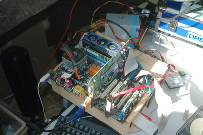

Currently on the test bench:
The i815EP chipset.
Candidate: Asus TUSL2-C
BIOS: 1012, up from the original 1007
AGP: Quadro 4 900 XGL 128MB
Promise TX4-Sata 300 in PCI-slot 3
Win2K is being installed.
    190.63 KiB
    3489 views
Reply 6 of 61, by candle_86
The 440bx boards won't run an agp 8x card they are 3.3v electrically which Radeon 9600 and 9800 don't support as well as all ati Xxxx cards
Reply 7 of 61, by flupke11
candle_86 wrote on 2020-04-25, 21:27:
I'd agree on the BX, but the i815ep, being far more modern, suprised me in not running the 9700/9800. It runs the X850 without issues...

Results are in for the TUSL2-C [Windows 2K and on Nvidia drivers 45.23]
I don't know why CPU-Z reports that the AGP is at 2X, while 4X is selected in BIOS and the Quadro is clearly an AGP 4X generation.
At FSB 133 , CAS2 consuming 108W (MB, GPU, SATA)
3Dmark2K: 10087
3Dmark01: 9242
Q3Ademo four.DM68: 159,8
Sisoft99: CPU 363 MB/s - FPU 355 MB/s
At 150 FSB, CAS3 consuming 111W
3Dmark2K: 10804
3Dmark01: 9693
Q3Ademo four.DM68: 168,2
Sisoft99: CPU 365 MB/s - FPU 364MB/s
Reply 11 of 61, by greasemonkey90s
flupke11 wrote on 2020-04-25, 23:21:
You need to relash it with the evil bios. Its a common issue with the vanilla asus bios.
http://www.x86-secret.com/articles/tweak/i815twken.htm
Reply 12 of 61, by flupke11
Thx!
I've updated and rerun the tests:
At 150 FSB, CAS3 consuming 108W, with modded BIOS 1011 and Nvidia 45.23:
3Dmark2K: 10847
3Dmark01: 9803
Q3Ademo four.DM68: 174,8
Sisoft99: CPU 377 MB/s - FPU 370MB/s
A nice boost. I'll start testing a second system soon.

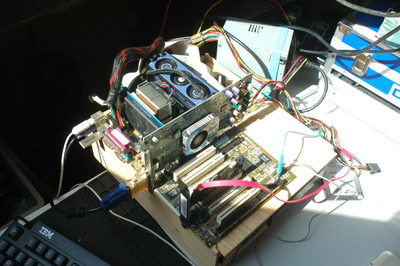

Reply 13 of 61, by flupke11
Quick test with the same install on the Asus P3B-F
FSB 150; same ram as TUSL2-C, Upgradeware Slot-T, Promise on PCI 4
3Dmark2K: 11552
3Dmark01: 10397
Q3Ademo four.DM68: 185,5
Sisoft99: CPU 447 MB/s - FPU 484MB/s
Impressive results for the oldie of the bunch...
198.83 KiB
3303 views

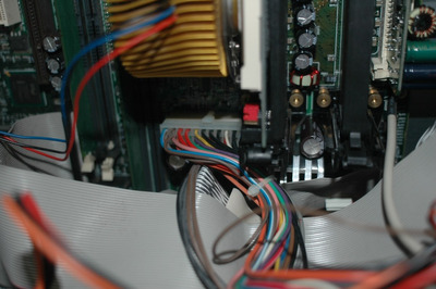

Reply 14 of 61, by dionb
Slight side-question: I might just be receiving that Compaq i840 board in the near future (or otherwise some other Compaq i840 model). It seems to have an ATX-like-but-bigger connector. What PSU are you using? An original Compaq PSU or a generic ATX?
Reply 15 of 61, by flupke11
dionb wrote on 2020-04-26, 15:11:
I got lucky, I got an original AP550, so it's using its original Compaq PSU with a 24-pin ATX-style connector and an additional 6-pin.
149.8 KiB
3281 views
132.63 KiB
3281 views

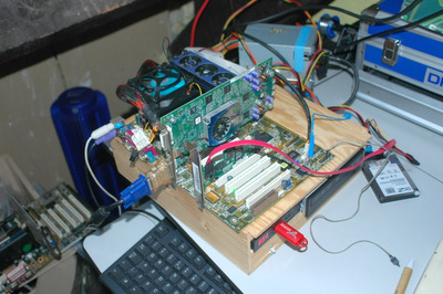

More results before I venture outside:
Results are in for the ECS P6S5AT [Windows 2K, Nvidia drivers 45.23, SIS 121 AGP driver] on DDR.
Chuffed it passed the test of installing Win2K and running all tests without lockups. That means my crude recapping was successful.
176.14 KiB
3276 views
At FSB 133 , max about 100W (MB, GPU, SATA)
3Dmark2K: 10638
3Dmark01: 9646
Q3Ademo four.DM68: 168.6
Sisoft99: CPU 441 MB/s - FPU 437 MB/s
Currently, no OC options on this chipset, although the CPU clearly has no issues doing 150 FSB.
It is picky with ram, I had to use 1*512 MT PC-2700U-25330-B1
The Sdram I used on the BX and i815 does not play with the SIS.

Reply 19 of 61, by dionb
flupke11 wrote on 2020-04-26, 16:06:
I got lucky, I got an original AP550, so it's using its original Compaq PSU with a 24-pin ATX-style connector and an additional […]
Lucky!
One last request: could you see if the board boots without the 6-pin? I actually have a 200W Compaq 24p PSU from 1999. If it might boot with just the 24p I can use that to test it. If it's alive I'll shell out on one of those 375W and 1.5x ATX height monsters 😉
Edit: sod it, just ordered the 375W PSU.
FYI I have the P6S5A-T and an i815E system too, so potentially could double-check stuff if needed - although I don't have time to do a full project like you are doing.
