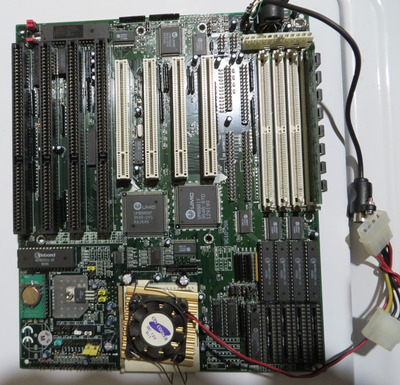

I successfully added PS/2 support to Disruptor's Shuttle HOT433 (rev 1, 2 or 3) mainboard (using an external KBC). This post is a detailed explanation on what needs to be modified on the board to switch it to external keyboard controller support, and suggests a BIOS image that can be used as base.

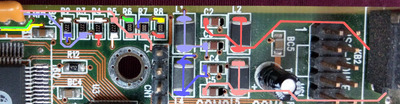

This part shows the traces from the keyboard port and the 10-pin header for the mouse (pin 1 is at the top right corner, pin 2 at the top left corner, pin 10 at the lower left corner) going towards the keyboard controller. It connects the standard pins from the DIN socket (and the soldering pads for the alternate option for a PS/2 keybord socket at the same place) to some vias that connect to very import zero-ohm resistors shown in the next picture. The pinout of the 10-pin mouse header ist like this:
  • Pin 2: GND
  • Pin 3: Mouse data
  • Pin 5: +5V
  • Pin 10: Mouse clock
Except for the red and blue wires from the port, the top right corner also shows a yellow and a green trace. These traces are directly connected to the chipset pins listed in the first table.
pull-up and "configuration" resistors between the sockets and the super I/O chip

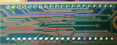

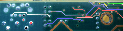

On the other side at the board, you find the following layout:
138.47 KiB
2800 views
This picture shows the L/C filters for the keyboard and mouse clock and data lines (where no attempt is mode to use different colors for the "external" and "internal" side of the L/C filters). This picture also shows the pull-up resistors for the clock and data lines. Keyboard clock is filtered by C2/L2 and pulled up by R4, keyboard data is filtered by C5/L5 and pulled up by R5, mouse clock is filtered by C4/L4 and pulled up by R2, finally mouse data is filtered by C3/L1 and pulled up by R3. Notice the white color-code (for +5V) on the opposite end of the pull-up resistors.
If no external keyboard controller is present, keyboard clock and keyboard data need to be directly connected to the yellow-coded and green-coded line from the chipset. This is achieved by R6 and R8. If you want to use an external keyboard controller, remove R6 and R8. R7 is a kludge for an external AT keyboard controller without PS/2 mouse support. An AT keyboard controller has the keyboard data line connected to Pin 39, whereas a PS/2 keyboard controller has the mouse clock at the same pin. So the purpose of R7 is to connect the keyboard data line (light red) to the correct pin of an AT keyboard controller. As the goal is to install a PS/2 keyboard controller with mouse support, remove R7.

Summary
So, in a TL;DR manner: To enable the PS/2 mouse port on your HOT433 boards, do the following tasks:
  • Remove R6-R8 (0-Ohm resistors next to the PS/2 mouse pin header)
  • Remove R30 (0-Ohm resistor near the 7406 socket)
  • Move the 10kOhm resistor (marking code "103") from R20 to R24. Originally, R24 is absent, after the mod, R20 is absent.
  • Plug a 7406 chip into the empty socket marked 7406 (between the ISA slots)
  • Plug a PS/2 compatible keyboard controller into the empty socket marked 8042. Preferably avoid contacting pin 2 by pending this pin out of the socket.
  • Flash a BIOS with PS/2 mouse support enabled, for example the one included in this post
EDIT: Added the story about bending the clock oscillator output pin.
To undo the modification, revert all the changes, except you don't have to re-install R7.

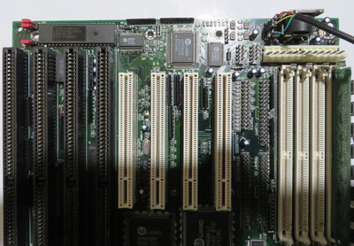

Reply 12 of 25, by mockingbird
Fantastic mod, thanks 😀
I did not socket the KBC, for fear of the added height interfering with ISA cards. I bent pin 2 out, and it's touching the back of the ISA slot.
The PS/2 worked perfectly fine with my Avocent KVM (tested with Microsoft Mouse driver and Monkey Island). All I can suggest is to try a different KBC. I used a Mega-KB revision F. I must have pulled this thing off of something decades ago. I never thought I would end up using it. Just goes to show you.
