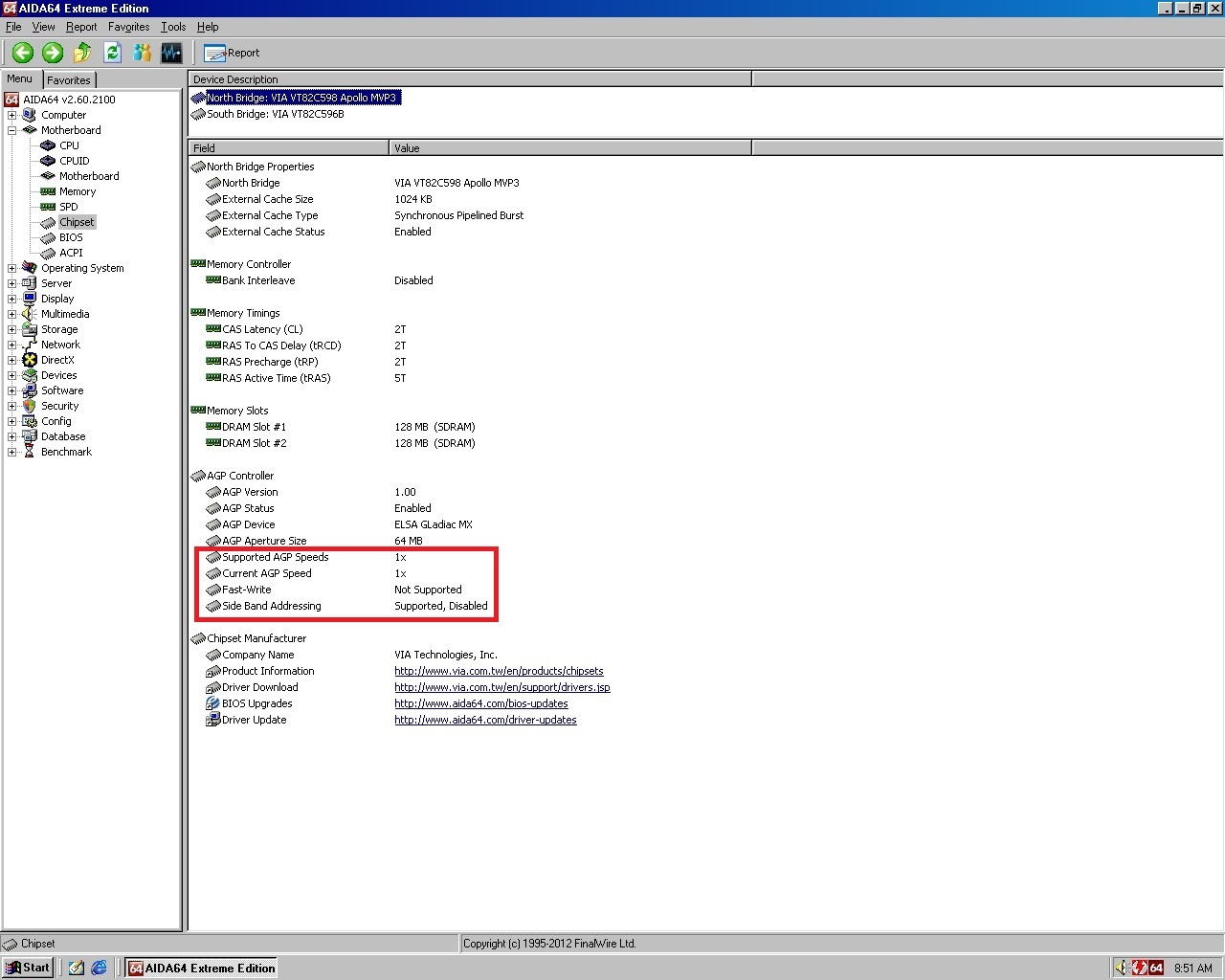

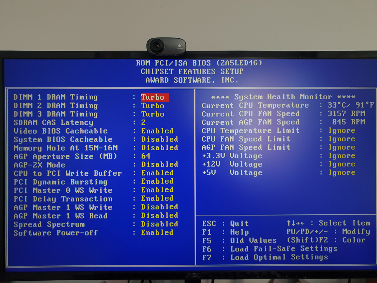

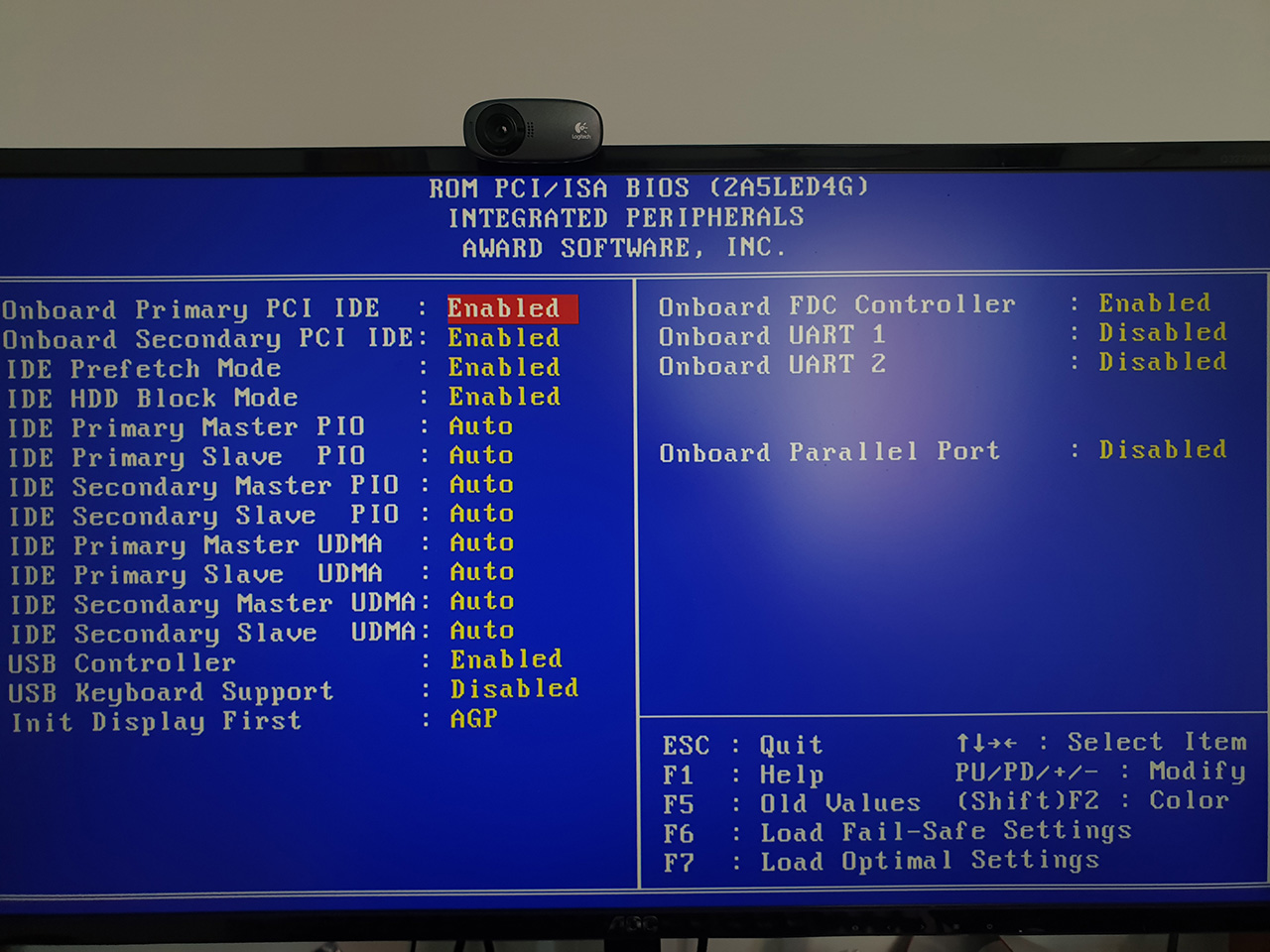

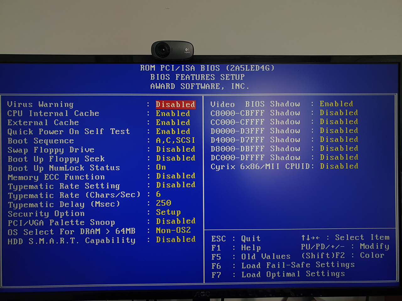

Reply 15 of 49, by bloodem
That's too bad... can you check with Everest/Aida32/Aida64, and make sure that you are on AGP 1x ?
Also, can you tell me what video card you are using? The lockups can also occur if you are on a power hungry video card (that's because many SS7 boards have an underpowered AGP). So my recommendation is to first try a GeForce 2 MX, because it has very low power requirements that should be supported by most (or all?) SS7 boards. I actually think the GeForce 2 MX/MX400 (the 128 bit versions) are the best cards for SS7 systems, especially because the hardware T&L (or more specifically, the "T"), will boost the performance in many titles, including Quake 2. Also, they have excellent DOS performance & compatibility (because why else would you build a SS7 system, if not for its "time machine" capabilities? 😀 )
Oh, and you could also have RAM issues (although lockups are less common with RAM problems, the usual behavior is BSOD). Did you try multiple RAM modules?
Many things need to come together on a SS7 platform to make it stable. That's why I love playing with them and debugging all problems 😁
My current AGP aperture size is 64 MB (the default). But if it helps, check the screenshots below, you can see all the important BIOS settings that I currently have.
In Everest/Aida, you should see something like this:
