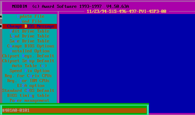

MAME also lists this version:
	// 5: BIOS-String: 11/23/94-SiS-496-497-PVI-4SP3-00 / #401A0-0101
ROM_SYSTEM_BIOS(5, "v10101", "ASUS PVI-486SP3 V1.01 #1")
ROMX_LOAD( "0101.bin", 0x00000, 0x20000, CRC(7862ca56) SHA1(e609585893b23db10c4ae7d2abd17cc9dda964b6), ROM_BIOS(5))
which is nowhere to be found.

Here it is:
27.67 KiB
237 views
0101.zip
60.37 KiB
12 downloads
Added this BIOS to UH19 as well: http://www.win3x.org/uh19/motherboard/show/816

Reply 9 of 9, by shock__
BastlerMike: Yup, but I wanted to use the integrated IDE port. Also the system ran incredibly unstable when using VLB graphic cards with a more modern BIOS + ISA IDE.
0101.bin works on my A4 (only briefly tested IDE + DX2 + VLB so far), SI4I0101.AWD did not.
Thanks computerguy08
