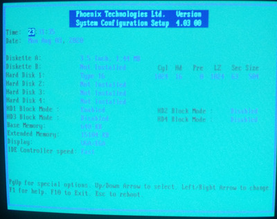

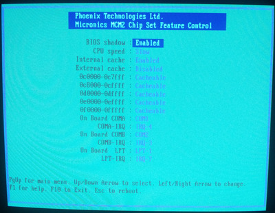

In the meantime I'll try to play with the aforementioned jumpers on the graphic card and check for those bios settings even though I'm pretty sure there are no such options. The only setting specifically for graphics card is the type of the adapter: monochrome, cga or vga/ega, which in the end it doesn't seem to do anything meaningful.

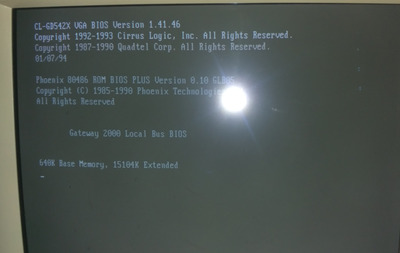

These are the only options my bios shows:
NOTE: cpu speed is set to slow because this way the Turbo button can be used. If set to fast the turbo mode is always on no matter if the switch is pressed or not.
file.php?mode=view&id=89323 file.php?mode=view&id=89321 file.php?mode=view&id=89322

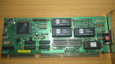

It has been years since the last time i pulled out the card and it turns out I remembered the wrong model, not that it changes something, but its a 5428 (despide the fact that various programs reported it as a 5424).
download/file.php?mode=view&id=89327
