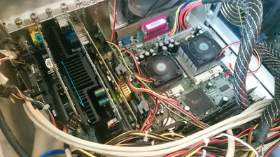

My file server for many years was based around a HP tc3100 motherboard with dual 1.4 tullys, 4 GB RAM and running Windows Server 2003.
The problem with these server boards of course is that you don't get an AGP slot so they will never be good gaming machines.
ETA: This may be of interest to the OP. After retiring the server mentioned above, I decided to turn it into a gaming system running Windows XP. The specs were:
Cooler Master Stacker 830 case
Enermax Noisetaker EG701AX-VE(W) 600W ATX PSU
2 GB RAM
Sparkle GeForce 8500GT PCI
1 TB HDD on RocketRAID 1820A PCI-X SATA controller
Acer M5271COMBO USB 2.0/FireWire 400 PCI
Creative Sound Blaster Live! Value PCI
3Com 3C996B-T Gigabit Ethernet PCI-X NIC
The reason for the 8-port RocketRAID is that it was part of the old server. Same for the 3Com NIC and PSU. I also reduced the memory from 4 GB to 2 GB to speed boot time. (You can't skip the memory test on this machine.)
That video card runs very hot. Not visible in the picture is a 12 cm fan that I installed over the cards blowing air down onto them. (I have since acquired a beefier PCI card, a Zotac GeForce GT 610, which I may install here someday. It is also passively cooled and runs very hot.)
