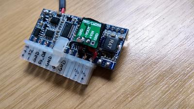

Anyone got any hot leads on one of these, preferably as cheap as possible?
Or a way to mod an ATX PSU with the missing pin to supplying -5v? (Soldering is fine by me)
And yes I do need the -5v, for a GUS Max 2.1

Some of the ATX to AT adapters include a small linear regulator to generate the -5v rail, and that's an option to consider -- the current draw on -5v is minimal, so there's no need for anything fancy. (I believe they use something basic like a 7805 hooked up to the -12v rail?)

Using the -12V line and a L7905 (T220 -5V Linear regulator IC) would work well. As for ATX supplies, most all new ones do not have -5v, you need to look for older ones but they most likely need re-capping.

You can also solder LM2662 module to +5V line, it will turn it into -5V. It should provide 100mA. Here i soldered it directly to pico psu, I also added a protective Schottky diode on -5v output (it may drop the voltage a little as side effect), to minimize risk of passing positive voltage in case of failure.
