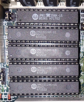

pic of current l2 cache chip below
    399.04 KiB
    1450 views
    current l2 cache chips

When you flash a BIOS, settings can be restored to defaults. The -15 in the name can mean 15ns, go through the BIOS and see if there is anywhere to set that. It also looks like you have 256KB of cache as you have 4x512Kb and the 256Kb may be a parity chip.

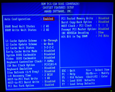

had a look and defaulted the bios and can not see anything about ns timings

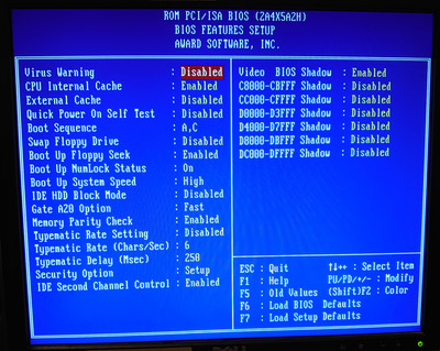

here pics of what settings the bios has

    bios screen 1

    bios screen 2

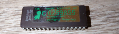

i can't remember what version the original bios was but pic below with label on it

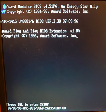

the version i updated was
file.php?mode=view&id=94758
i didn't find any other revision of my mobo and went to a website i use before when updating my socket 7 penitum build a while and seem to be ok
i have attached pic and the rom file of both bios
original bios - i backed up via awdflash before i buggered the eprom
the updated bios - i used to flash to new eprom via a programmer
    488.16 KiB
    1419 views
    updated bios

    orignial bios chip label
