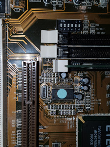

How do I recognize the clockgen on the motherboard?
there are 3 switches on the motherboard that control the fsb.
off-off-off 66Mhz
off-off-on 100Mhz
off-on-off 75Mhz
on-on-off 85Mhz
on-off-on 95Mhz
These are on the manual, so that would leave on-on-on, off-on-on and on-off-off combinations to be the only ones not mentioned there
Edit: Looking at manual of later revision of the motherboard it seems that off-on-on is 112Mhz and on-off-off is 124Mhz and that would leave on-on-on the only possible combination.
Edit: Found the last combination. on-on-on seems to be 68Mhz. It is written on a table on the motherboard.
Reply 9 of 61, by cyclone3d
On the sy-5ema+ I am pretty sure it is the ic nestled between the RAM slots, AGP slot and the Northbridge chip.
on-on-on might be 68.5... depends on if the different revisions use the same exact clockgen.
Yamaha YMF7x4 Guide
Epstein didn't kill himself
Reply 11 of 61, by cyclone3d
Yes, almost 100% sure that is it.

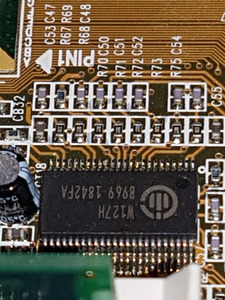

Reply 14 of 61, by Baoran
cyclone3d wrote on 2020-10-25, 07:04:
This is what I found under the sticker. Unfortunately google didn't find anything when I put those numbers and letters there.
1.6 MiB
542 views
Reply 16 of 61, by Baoran
gbeirn wrote on 2020-10-25, 08:15:
Thank you very much. Unfortunately there is no 60Mhz there. Quite limited amount of frequency selections there.
