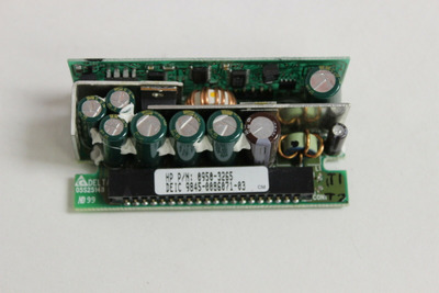

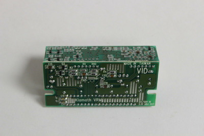

It comes with only 1 Ppro 200 mhz (and, only 1 VRM). I've got another 2 PPro's CPUs matching batch code, but my problem is the VRM...
After searching in google a lot of time for part number, and mailing like +10 old hardware providers, only 1 answered...($999.00!. NO way!)...
I've found this at EBAY for $25 to $50. (Seems to be for P2 klamath)
142.17 KiB

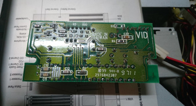

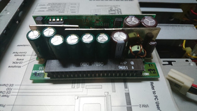

And this one, it's the VRM running on the HP Vectra: (PN 5063-8794, not printed on VRM, HP manual)

At first look it's nearly identical, it even got the "circle" marked on the circuit board for the missing capacitor
Maybe with minor modifications i can mod that klamath VRM...?
What do you think?.

Reply 1 of 3, by Errius
HP VRMs: http://www.chris-winter.com/Digressions/HP_Ka … k/Volt-Reg.html
I assume the one that came with your computer is a 0950-3066?
“I like to dissect PCs. Don't you know I'm utterly insane?"
Reply 3 of 3, by eisapc
PC Hoarder Patrol wrote on 2020-11-02, 21:46:
According to the HP Vectra XU 6/XXX Service Handbook the part # is 5063-8794
The same number ist listed by partsurfer.hp.com.
