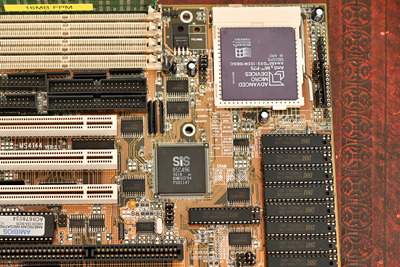

i have a 486 Mainboard "MSI MS-4144" that originally came with an Intel 486 DX2-66Mhz and i upgraded it with an AMD 5x86 X5-133 ADZ.
When i tried to boot from floppy to install MS-DOS 6.22 it would hang at "Starting MS-DOS" until i disabled L1 Cache in the Award BIOS. Other cache related BIOS settings didnt help (ex. setting Write-Through or Write-Back or disabling L2 Cache).

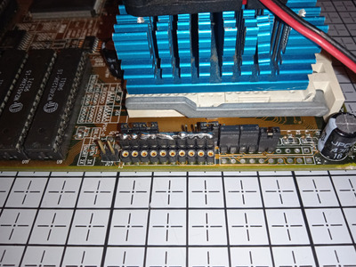

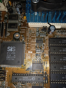

So i went ahead and re-checked the board if it was configured correctly regarding the CPU jumpers JC1 - JC6 but i am right now unable to identify how i have to set the jumpers. Maybe someone could give me some tips?
I think it is still configured for its original Intel 66Mhz CPU.
Also, the PC did not come with these Resistor Arrays(you can check in the pics - JC1 and JC6) but i assume, if i had to use them, these are zero Ohm arrays and i could probably still buy them?
Edit: Just so you dont get me wrong, the voltage is already set to 3,45V and the FSB is set to 33Mhz and the CPU Multiplier is set to 2x. I am just unsure how to set JC1-JC6 since the manual doesnt say what these jumpers do.

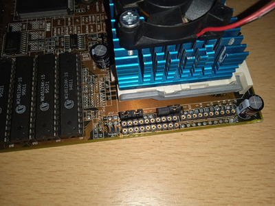

i just desoldered the 10 pin receptacle JC3 and tried to use it as the 0-Ohm resistor array in JC1 , so i connected all pins on the top side. Then the PC didnt boot. So i reconnected all the pins pairwise (pin 1&2, 3&4, and so on..) which worked. The picture below shows the wrong configuration. Fortunately nothing blew up.
in place of JC3 i soldered a 6x1 pin header and put 3 jumpers on it, like in the picture from mpe 2 posts above.
everything works fine now, thanks again for the help.
