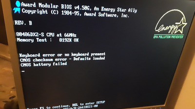

Mounted in 486 , tried different combinations till I figured out how to setup bios hdd in user mode, setting up the drive by copying settings from EZ into bios - mine was int 13h - 80h cyl524/h255/sect63- capacity 4302MB &the rest off.

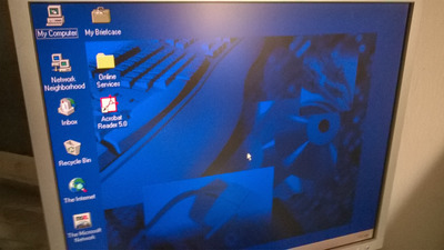

So after disabling everything it finished installing win95 on 8mb of ram. It turned out that from main Award 4.5 menu the Second cpu cache - External cache ! was the culprit .
Turned on nothing worked turned off windows would load. (I don't know rest , because I keep turning everything on and loading windows , all worked ok , at least seems so ). I will have to check memory for additional errors.
