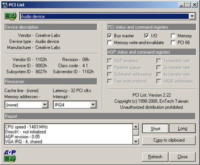

Which driver CD or driver set are you using ?
Can you post the card's PCI device ID for the card, you can use pcilist.exe : https://www.majorgeeks.com/files/details/pci_list.html ?

If you can post the equivalent of this screenshot for your card, it will include all required info (Vendor ID , Device ID , Susbsytem ID) :

The VXD drivers on the CD you linked to do not directly support your SB0100 variant (8069h Subsystem ID) . The WDM drivers do, which is likely the reason why they get installed despite you choosing the VXD ones .
As a workaround, I have modified the VXD drivers from that linked CD in a way that should let them work with your card . If you have trouble installing them, try the method mentioned here : Re: VDX-drivers for Audigy 2 (not ZS!!)

b) I only use the digital (S/PDIF) out with an external DAC .
c) AFAIK, this model works with pretty much any driver (inf mod sometimes needed)
What does (b) mean? What else would you use it with?
Sorry for the lack of clarity. I meant as opposed to the analogue outs, which I never use .
Oh that makes sense. I currently use the SB0100 in a "late win98" PC (think P4 3ghz etc) with WDM drivers, and playing 2000+ games (e.g. bf1942) and it sounds and works fine. If I was building a "early win98/win95" machine (e.g. 95'-99 games), I would certainly use a card that worked with VXD drivers. Only problem, that era of systems I usually build around s370 boards with Via chipsets that have their own issues with SB Live!...
