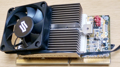

I am trying to get dual Tualatin setup working (some details here Tualatin BIOS update for Tyan S1834D (Tiger 133)) with my Tyan S1834D motherboard, so I got two MS-6905 Master slotkets, but different revisions (VER: 2.3, VER: 2)

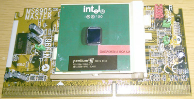

I successfully modded MS-6905 VER 2.3 (i made 3 holes larger and insulated them), it works with wire-modded Pentium III-S SL5XL 1.4GHz. I wanted to add a second CPU, so I performed the same mod with VER: 2 slotket.
It didn't work at all with P III-S 1.4GHz (SL6BY this time), so I un-did the mod and tested it with Coppermines. 733MHz (133MHz FSB) P3 didn't work. Then I set the jumpers on the slotket to 100MHz and it worked, detected as Pentium 550MHz. Pentium III 800MHz also worked at 100MHz. But I always got a black screen when FSB was set to 133MHz.
This is my working Pentium III-S SL5XL 1.4GHz with MS-6905 Master VER: 2.3 slotket (2-3 on JV0, JV2, 2-3 on J3 /this shouldn't be important here/, other jumpers are open):
686.49 KiB
3722 views

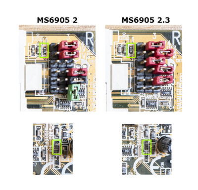

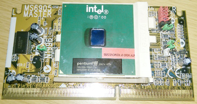

When I set identical jumpers on VER: 2, it didn't work with Tualatin or Coppermine.
I also tried different jumper settings on VER: 2, auto voltage (1-2 on JV0,1,2,3,4) FSB 133 (J4 and J1 open). Tested with 733MHz P3. Didn't work.
740.86 KiB
3722 views
These jumpers did work with 733MHz P3 and 800MHz P3, but they were in 100MHz FSB mode (1-2 on JV0,1,2,3,4; 2-3 on J4):
799.63 KiB
3722 views
Any ideas what could be done to fix it? I only tested these CPUs in single slot, I didn't try running both Tualatins at once. Are there known differences between VER: 2 and VER: 2.3 that can be fixed so they will perform the same? I could take high-res photos of both but maybe someone already knows could be the problem.
EDIT: Ver: 2.3 has TVC16222A chip. VER: 2 has just TVC16222 chip. Could non-A version be unsuitable for 133MHz operation? I could buy new version and replace it. It is still being produced. But I don't know if it makes any sense.

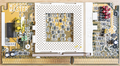

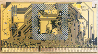

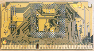

Update: I made some high resolution photos.
Version 2.3:
1.85 MiB
3696 views
GPL-2.0-or-later
1.82 MiB
3696 views
GPL-2.0-or-later

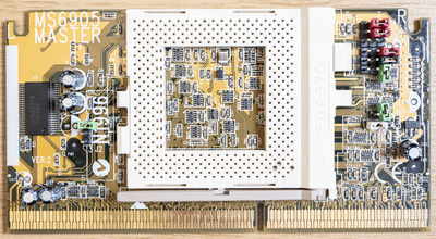

Version 2:
1.89 MiB
3696 views
GPL-2.0-or-later
1.77 MiB
3696 views
GPL-2.0-or-later
The most obvious difference is additional capacitor on the back in Ver 2.3. I read somewhere that it should be 47p. I only had 18p of that size and soldered it, but didn't help. Other difference is value of RNs. They are 750 in Ver 2.3 and 560 in Ver 2. And different revision of TVC chip. Should I try to replace resistor arrays on Ver 2 to match these on Ver 2.3?

Hmm, so I wonder what may that be. I swapped the CPUs between slotkets and same SL5XL didn't work in V2. Do you have R750 or R560 resistor networks?
I found out that under ver 2.3 sticker is ver 2 silkscreen. So ver 2 may be ver 2.3 without a sticker.
Maybe my motherboard is more sensitive to signal level it gets from the cpu than others.

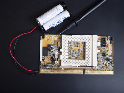

Now my Rev 2 slotket stopped working completely. I measured 7 ohms on some ceramic and electrolytic capacitors, so I hooked up a battery pack and sprayed the board with alcohol to find out where it evaporates quckly. It was that ceramic cap close to the edge. Who would've expected such failure. Works again after being replaced. But it still doesn't work with 133MHz CPUs in my dual CPU board, while Rev 2.3 works.
727.46 KiB
3515 views

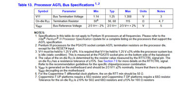

I just found in Intel's datasheet that 56 ohms (not 560; SMD R560 code = 56 ohms) is valid for "Coppermine-T UP" plaftorms, while "Coppermine-T DP" requires 68 ohm. But maximum resistance is up to 115 ohms.
38.23 KiB
3515 views
https://www.dexsilicium.com/Intel_Pentium3.pdf
Tualatin datasheet has similar specs. "Uni-processor platforms require a 56Ω resistor and dual-processor platforms require a 68Ω resistor. Tolerance for on-die Rtt is +/-10% (56, 68Ω resistors). Rtt is +/-15% (100Ω resistors)." http://www.frsn.utn.edu.ar/tecnicas3/manuales … ata%20Sheet.pdf

Update: Now I have two MS6905 2.3 slotkets. They both have 75 Ohm resistor ladders, but one has TVC16222A chip and other has TVC16222 chip. One with TVC16222 chip also doesn't have additional small SMD capacitor on the back.
The result: Each one of them works with 1400MHz 133FSB Pentium 3 Tualatins (SL5XL) in single CPU mode. So, it looks like resistor ladder values were more important than the TVC chip itself. However...
For dual Tualatin mode i had to connect X2 pin (not N33) to B75 pin on both slotkets with a wire. That's the only mod required so far. BUT it works in dual mode only with 100MHz FSB set...
With 133MHz it gets stuck on C0, C1, or CF code.
Maybe I will try soldering TVC16222A instead of TVC16222, as I bought some spares and see if it works, I can also try soldering missing capacitor. But I have proper dual S370 rig now, so that's not high priority. Anyway, maybe someone will find this info useful: resistor values on slotkets can be important.
