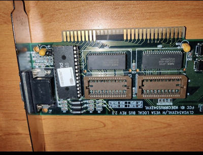

I've had a card exactly like that very GD5429 many years ago. If it has 60ns rated memory, it ought to be plenty quick enough for a 486 game box. (And you can squeeze a little extra performance out of it using the CIRBOOST utility.) I also noticed you found a QD6500 VLB card. That's a really good one, especially if you can find someone to burn an XT-IDE BIOS ROM chip to plug into that vacant slot. (What the XT-IDE BIOS ROM will do, is make using a hard drive larger than 503MB much less painful to set up and use. Many old 486 boards have incomplete or even non-existent LBA support, meaning you're often stuck with a 503MB or, if you're lucky, 2GB or so maximum drive size otherwise.)
    CIRBOOST.ZIP
    88.06 KiB
    38 downloads
    The file you want in this is CIRBOOST.COM, as that's the speedup utility. The others are just benchmarking tools, source codes and what not.
Looking at the part number, it is 60ns memory. I’m in no rush but I shall be upgrading it with 2 512kb 60ns memory chips very soon
In regards to the BIOS, my father had a EEPROM reader / writer, can we write the BIOS with that?
Can you use any old BIOS chip that physically matches and reprogram that?
It would be nice to be able to have large drive support. I chose the card for its performance, I never considered about large drive support, I just thought it wasn’t possible without a PCI controller.
Reply 22 of 37, by evasive
If the chip type this board has is in the list of supported chips, yes.
needs to be the same size and sometimes have the same cell organization. Your mileage may vary.
As for large disk support, most award 4.51PG bioses can be patched relatively easy, not so for AMI bioses it seems. We still miss the bios for this board in UH19 btw so if you could make a dump and post it somewhere that would be nice.

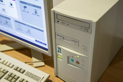

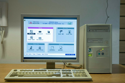

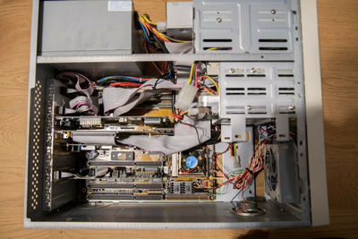

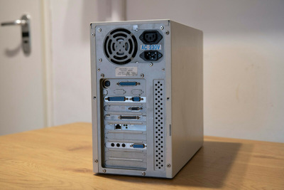

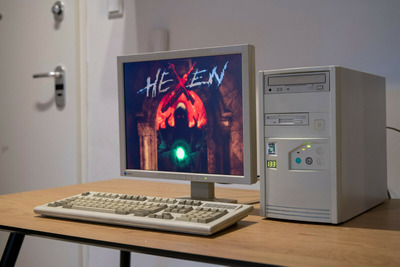

Thanks all. I'm too deep into the build to stop now. But not going mad with. Going to keep this one moderately specced out and keep it for really old DOS games.
I just lucked out on eBay and got a full system for £70. It knocks spots off the one earlier in this post.
Specs of the one I just won are as follows:
Processor: AMD 5x86 133Mhz Socket 3
Motherboard: Hsing tech Socket 3 PCI & VLB! 486AVIP
C2032 battery
RAM amount: 16Mb (2x8mb, 2 slots empty)
HDD: Seagate 3Gb
FLOPPY: 3.5
SCSI Controller & SCSI Sanoyo x4 CDROM
GFX: ATI MACH 64 PCI 2Mb
Sound: ISA Realtek RTA3000
Ethernet: SMC basic PCI ethernet
Comes with an AT keyboard but is a bit haggard.
I'm made up with it. Hope it survives the trip from Poland.

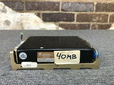

I did purchase one more thing. Some people hate these drives, but I think it gets respect for lasting 30 years on this earth and still working.
It's a Connor 40MB IDE HDD.

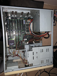

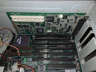

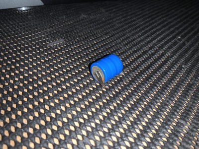

Reply 37 of 37, by Mvickers03
Most bits are here now.
Just waiting on the HDD and VLB cards.
It’s a painful wait. Some pics of progress so far.
Bye bye evil barrel battery.
