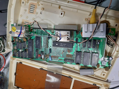

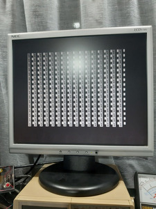

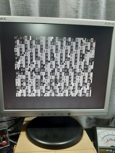

I tried to repair a VTech Laser 200 which wouldn't turn on. I replaced a faulty 7805 voltage regulator and disconnected the power cables from the RF modulator, which is shorted and is what caused the regulator to overheat in the first place. Now it powers up and outputs composite video, but it's all gibberish. At least I got the power supply issues sorted, now how do I proceed with the debugging? What else can I meter? I suspect that the SRAM chips are bad (both? only the one next to the MC6847P?), but given the random output I don't really know if the other circuit is okay, so I'm at a loss on what more to check. By means of a finger check, no ICs seem to overheat though. Since parts arrive late due to COVID these days, I'd rather try my best to pinpoint the components that possibly need to be replaced before I place an order, so any clue would be helpful.
Attached are photos of the composite video output I get, as well as a photo of the board. The grey bar-grey background capture is what I get most of the time, though the output is never consistent.
