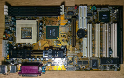

Hi Vogons,
it has happen that I have a working Commate P3-370A mainboard. It is a weird Socket370 and Slot1 combo motherboard. I got it together with a P3 600EB and 512 MB RAM.
I could find only very little information about this and there seems to be no manual available any more in the net. So I decided to document some things about this board to help other people.
And maybe someome here from Vogons has a manual for this.
I hope to get it working with a P2 233 MHz, Voodoo1 and an ISA Soundblaster or clone with DOS and WIN98.
1.75 MiB
272 views
Board Overview
The name on my board is P3/370A, but the name P3/370A-VP can also be found.
The company is know as Commate, Tcommate or Taiwan Commate. I also found DCS as manufacturer.
My board has the VIA VT82C693A & VT82C596B and therefore it is the P3/370A-VP. To bad my board lacks the optional ALS4000 PnP Sound Chip. It even has a unpopulated SB_LINK connector.
The important things like FSB speed and the multiplier can be set with jumpers on the board. To my surprise, all those settings are written on the board.

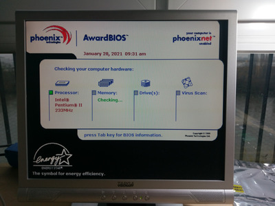

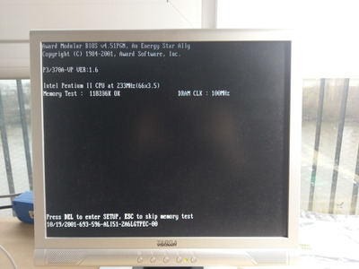

Edit 2021-01-28:
I now can confirm it working with a Pentium II with 233 MHz and the BIOS Version 1.6 that I posted before.
1.24 MiB
222 views
P3/370A-VP Quick Boot Post
1012.77 KiB
222 views
P3/370A-VP Normal Boot Post

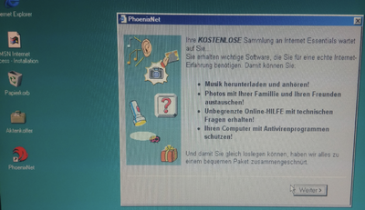

Oh, this is hilarious. On the first boot from hardisk, the BIOS installs a small tool onto my desktop to ask me if i want their "PhoenixNet Internet Essentials" downloading next time the PC has internet connection. It even puts a link on the desktop to this long gone URL: https://seqdl.com/servlets/Redir?BID=65457&CID9875
1.63 MiB
184 views
The wayback machine helps and shows a redirect to: https://web.archive.org/web/20010419192921/ht … phoenixnet.com/
Oh what...Look at this FAQ: https://web.archive.org/web/20010331052744/ht … bout/index.html
Q: How does PhoenixNet decide what tools to offer?
A: PhoenixNet carefully selects the best-of-breed products and services from respected technology manufacturers. Through a careful review process, PhoenixNet determines what type of tools and services would be most valuable to our users. Then we select the best providers of these products and enter into partnerships with them in order to provide these tools directly through our network, usually for free. We are always forming new partnerships and adding to our service in order to meet the needs of end users worldwide
I'm sure they always offer the most valuable, best-of-breed products for my free end user needs. I'm sold to this. 😆️
This would have me upset back in the days, but now it is just another curiosity from the past. 😂️
