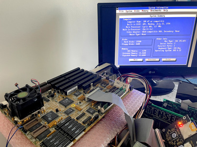

Reply 30 of 67, by retropc5x86
viper32cm wrote on 2021-07-10, 03:55:
I'm just come back to this thread. I had a bunch of crap come up for the past several weeks, so I'm just now getting back to th […]
I'm just come back to this thread. I had a bunch of crap come up for the past several weeks, so I'm just now getting back to this board.
I think I either have a misconfiguration issue or my board or processor is dead.
Before checking back here, I read through all the silk screen on the board and tried to decipher the jumpers tonight. I set the board for 5V and 33Mhz clock speed, set up a power supply, connected a PC speaker and monitor, and . . . nothing.
No video signal, no POST beep, no smoke, no sparks, nothing. My Intel DX2 did get hot--uncomfortable to the touch actually and I confirmed with my multimeter that the board was supplying voltage to the BIOS battery connections.

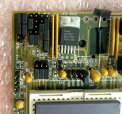

I was having the exact same results after removing the leaky battery. Turns out the corrosion had indeed damaged a few traces. This was my first board repair so I had to attach some ugly bodge wires but after doing so it finally worked.
I successfully booted using a CX486DX2 66 and an AM486DX2 66 using the jumper settings from the related (as per the BIOS string) board posted here previously.

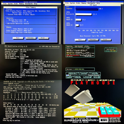

After some tinkering I managed to run an AM586 at the proper 133MHz (still shows up as a 100MHz Enhanced DX4 at the boot screen) using the jumper settings from this page: http://www.lejabeach.com/Biostar/MB-14Series/ … TAR_1433uiv.htm
Turns out JP20 was the key to getting the correct 4x multiplier (was previously only managing a 3x multiplier)
I also tried booting with a TI486DX4-100 and an IBM 5x86-3V3 100HF but no dice: either froze or boot-looped at the post screen.

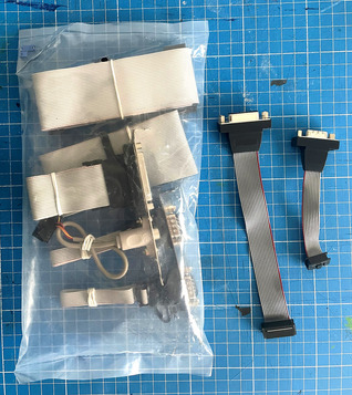

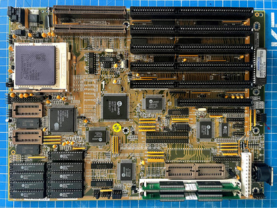

Attached are some pictures from the AM586, its jumper settings, and the Motherboard and the included accessories. I got it from the ebay seller posted here. If you're thinking about getting one do keep in mind that the board may need some repair from the corrosion.
This is my first post, and I'm not very well versed software-wise, but if there's any suggestions, tests or benches you'd like me to run, please do tell.
Cheers,
-RetroPC5x86

Reply 31 of 67, by viper32cm
retropc5x86 wrote on 2021-08-03, 02:58:
I've been on this board for three years, and your way ahead of me with your first post 😀. How many bodge wires did you have to do? I see the one on the photo on the top side of the board.
I'd bet that I have same problem with my board that you had. I just don't have the time or (if I'm being honest) the experience/skill to do those types of repairs.
Reply 32 of 67, by retropc5x86
viper32cm wrote on 2021-08-07, 04:28:

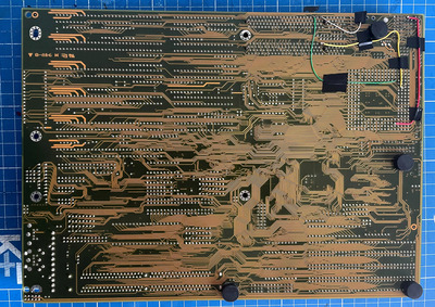

Originally I fixed 4 traces: 3 (white, green, yellow) via bodge wires and 1 applying solder over the broken trace. Then I blew another one (red), magic smoke and all, by placing the processor in the wrong orientation (yep, yikes). And regarding skill, I say go for it if you have the time, my first soldering fixes were atrocious, and my current ones still leave a lot to be desired -as the attached picture demonstrates- but they get the job done; and the feeling of fixing something is quite satisfying.

Reply 35 of 67, by retropc5x86
After a couple more tries I managed to boot with the TI486DX4-100 using the exact same jumper settings printed on the board (for a CX486DX2).
The IBM 5x86 is still a no-go. I'm leaning towards the BIOS not being compatible, even more so after looking at this compatibility list from Cyrix:
https://web.archive.org/web/19961221092122/ht … 86/5x-mblst.htm
It says the Biostar MB-1433 UIV board should support the 5x86 as long as it has the AMI 7/24/95 BIOS; but my board has a BIOS dated 7/25/94.
I've looked for the updated BIOS online but haven't find it so far.
So if anyone has an MB-1425/33/40/50 UIV Rev.7 board with the AMI 7/24/95 BIOS, please dump it.

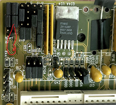

Reply 39 of 67, by tabm0de
Ohhh im no the only one that bought this board, doh i did give up after few test runs trying to get a DX2ODPR66 overdrive working.
I did socket it right 😉 at least what i remember but it seems that others ended up burning the same trace as the attached images.
At least what i can see its the same on @GeneralDisorder and @retropc5x86 pictures.
Does any one know where it was suppost to go to?
I currently running the board with a cyrix dx2 66 mhz.
Hope it is ok i stole the picture to mark.
