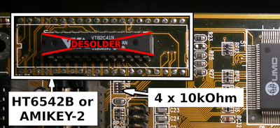

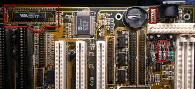

After applying multimeter to my LS-486e Rev:D I discovered that something is missing 😀
CN3 - 5-pin header
C5 and C7 - 47pF
L4 and L5 - 470uH
RP19 - 4 x 10kOhm
U29 - 74LS06
U30 - HT6542B or AMIKEY-2 (PS/2 keyboard and mouse controller)
And something is superfluous:
U28 - VT82C41N (keyboard-only controller)
I have not yet tried this 'cause I have a lot more other issues with this particular board. But I will as soon as I get through.
I'm going to update this post as I will get more information.

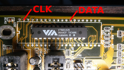

Reply 2 of 30, by maxtherabbit
Wait! Before you remove that mini-KBC please check if pins 1, 2, 18, and 23 go anywhere! I have a hunch that 1 and 2 might just be mouse clock and mouse data

Reply 5 of 30, by froller
majestyk wrote on 2021-02-11, 09:50:
Be careful, the "clock" trace from pin2 ending with an "empty" noose does not mean it´s ending there, buth the trace is continuing in some in-between-layer underground.
Sure.
It goes to unsoldered inductor L5 located right under SIMM slots along with inductors for keyboard data and clock. And it also goes to unsoldered 4x resistor pack RP19 which contains pull-up resistor for both mouse clock and data and 2 other things.
And it's not pin 2. It's 39. 😀

Reply 6 of 30, by froller
Here's datasheet on Holtek HT6542B which looks a good replacement for VT82C41N.
LS-486e Rev:D has similar schematics the one shown on typical application page for PS/2 mobos except additional inductors between CN3 pins and KBC. For test purposes these inductors can be replaced with jumper wires.
Pull-up resistors and capacitors are as shown in datasheet.

Reply 7 of 30, by maxtherabbit
froller wrote on 2021-02-11, 09:43:
maxtherabbit wrote on 2021-02-11, 02:31:
It doesn't seem they go anywhere at all. At least they certainly not connected to mouse data or mouse clock. They have approximately 1.5MOhm either to +5V or GND so they either not in use or even not connected inside a chip.
So you are saying that pins 1, 2, 18 and 23 on the VT82C41N do not have continuity to any of the pins on the DIP40 footprint?
Reply 8 of 30, by froller
maxtherabbit wrote on 2021-02-11, 13:49:
I say VT82C41N pins 1, 2, 18 and 23 are not connected to DIP-40 pins 28 and 39.
DIP-40 pins 28 and 39 known to match HT6542B pins for mouse data and clock.
DIP-40 pins 28 and 39 connected to pull-up resistors RP19 and connector CN3 via inductors L5 and L6.
That perfectly matches typical application schematics of HT6542B.
The conclusion is: NO you can not tie PS/2 mouse to VT82C41N in the way you suppose to.

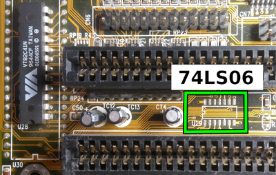

Reply 12 of 30, by maxtherabbit
Oh by the way - as I'm sure you noticed from looking at the HT6542B datasheet's app notes - pins 28 and 39 are the mouse data and clock inputs. The chip also has output pins that need to be connected to the header (via the inductors of course) after being buffered through a 7406 inverter. There doesn't appear to be a footprint on the board for the inverter or any equivalent logic
Reply 13 of 30, by froller
maxtherabbit wrote on 2021-02-12, 01:33:
Luckily you noticed it!

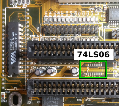

Here's the footprint for 74LS06.
1.96 MiB
974 views
74LS06

Reply 15 of 30, by froller
maxtherabbit wrote on 2021-02-12, 14:43:
Good catch. I don't own a rev D personally, my rev C has no such footprint. Trying to solder that SOP in between ISA slots is gonna suck
Many things become possible if you have soldering heat gun and roll of aluminum foil.
Just cover ISA slots with a paper napkin and 2 layers of foil and it should be more than enough to save them.
