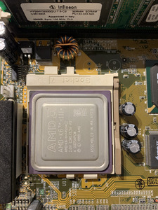

I compared the pictures of the two sockets. It looks like that is possible to fit a socket A cooler also on a socket 7 mainboard?
Anyone tryed that before?

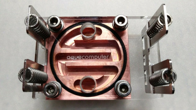

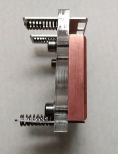

Reply 5 of 13, by Jackhead
Yes i see also the caps near the socket as problem for the most cooler. I want to cool a K6 3+ with OC.
I also found this watercooler here:
248.81 KiB
1081 views
What is really cool, i think was the first block from aquacomputer for socket A. Will try in the next day if this one fit on the Asus P5A.
Maybe than i build a SS7 watercooled system for fun 😀

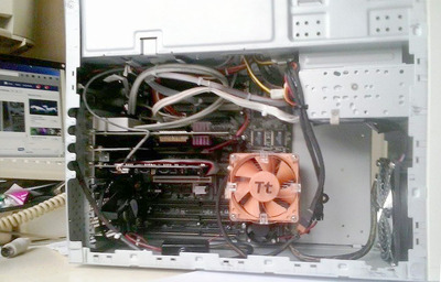

Reply 6 of 13, by PARKE
In the past I had a Thermaltake Volcano 7 on a QDI socket 7 board.
173.33 KiB
1068 views
But as pointed out in earlier posts it is very much dependant on the way how the socket is located in relation to capacitors etc.. You need sufficient free space around the socket for this type of heatsink which the QDI has because the socket is located at the side of the MB.
And there is, alas, not much free space around the socket on the ASUS P5A because it is surrounded by relatively high capacitors plus the socket for the psu cable.
Reply 7 of 13, by Jackhead
Yes another idea was to use a copper plate between the heatsink and cpu to get out of the caps.
But i really hope the aquacomputer block will fit perfect. The side finish with the socket to get no trouble with the atx connector. I will see.

Reply 10 of 13, by Jackhead
Well it might be overkill, but the water cooler itself is not up to date like the water blocks today.
Look at the waterflow .. It was the first cooler from aquacomputer "Cuplex" they made august 2001 so its not really something ordinary for the timeline.
Here a link from the company, sorry only german: https://www.aquacomputer.de/cuplex.html
Im lucky they still have some G1/8 connector for it because the rest is G 1/4 .
I dont expect to much from it. But when it cools down the K6 3+ something around OC 550-600MHz without problems im pretty happy with it.
Hope to get it end of the week i will give you some pictures than.

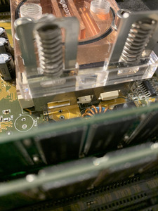

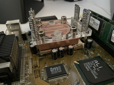

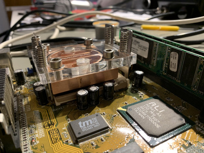

Reply 11 of 13, by Jackhead
The cooler fits perfect, but i order to place it on the mount i have to desolder first the caps to not damage them. But ok.
1.81 MiB
931 views
installed, i had to leave the pwr_fan header removed:
1.76 MiB
917 views
1.19 MiB
917 views
1.58 MiB
917 views

Reply 12 of 13, by arrow_runner
Jackhead wrote on 2021-02-13, 09:47:
The cooler fits perfect, but i order to place it on the mount i have to desolder first the caps to not damage them. But ok. IMG_ […]
What were your results with this water cooled setup?
Reply 13 of 13, by Jackhead
System runs fine on 550MHz, i dont have benchmarks any more because i skipped SS7 to a 586 S7.
