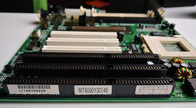

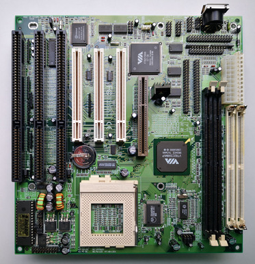

Hello,
Recently got this:
922.24 KiB
262 views
431.51 KiB
262 views
9 of 11 main capacitors were bloated, so I replaced all of them with Panasonic FR.
There are no means to identify the board, so I hoped the BIOS string would provide some answers. Sadly, the board gets stuck during POST at C3 0C.
Tried with 2 CPUs (Pentium 120 and K6-2/333), two known good PSUs (both ATX), various sticks of SDRAM and EDO, with and without a PCI or AGP video card. When starting without any RAM it stays at C1 00 which is standard behaviour, but at some time it stopped beeping when powered like this, and now it's completely silent.
The board looks great, without a single scratch, and apart from some dead chip (maybe from powering up or using it with the destroyed caps, by the previous owner), it might be a matter of corrupted BIOS image, but without knowing the model I don't know where to look for a BIOS file.
Lastly, this might provide a clue: the jumper for selecting Flash chip voltage is labeled 'JVROM1', and from what I found on the net this name was used by DTK and Gemlight (but the boards that I found are completely different, ATX form factor...)
Reply 1 of 10, by Deksor
C1 and C3 are steps related to RAM.
What kind of RAM did you install there ? SDRAM ? EDO ? did you using matching pairs of EDO ?

Reply 2 of 10, by quicknick
At first I tried with the few sticks I had at hand, but in the end got my boxes out and tried about a dozen memory configurations (matched EDO and FPM pairs, SDRAM sticks from 32 to 256MB, PC66 to PC133), to no avail.
Then, following my hunch about the BIOS, I tried with a Soyo 5EHM image, and it posts! I have attached a floppy, and it seeks at the POST screen, so the super i/o must be somewhat compatible or maybe identical, but I can't get any further because it complains of keyboard error or KB not present. The keyboard is connected and it receives +5V and I didn't investigate further.
I then tried a LuckyStar P5MVP3 BIOS and it posts with this too, sans the floppy seek, only to stop at the same keyboard error.
Is there any use for trying to solve this error, or might it be caused by the fact that I'm using a BIOS that is perhaps too different to the original? I don't see much sense in using the board with another's BIOS, even if I remedy this somehow.

Reply 3 of 10, by Deksor
Thanks for the dump !
It's apparently a ENPC EP-PI11. POST string is 06/01/1998-VP3-586B-W977-2A5LEEC9C-00
I don't know that brand but now there's a name to look for.
Edit : you can find the latest bios here, version 2.0A https://www.elhvb.com/mboards/enpc/bios/index.html
and manual here https://www.elhvb.com/mboards/enpc/manuals/index.html

Reply 7 of 10, by quicknick
Glad to report a success, I'm deeply grateful for the assistance! Went straight to the 2.1A bios from UH19, everything works now.
This bios presents two options that I don't remember seeing on other SS7 boards:
POWER ON Function [Button Only/Keyboard 98/Password/Mouse Left/Mouse Right]
KBC input clock [6/8/12/16MHz]
Any of these might have caused the keyboard error when using 'foreign' bios images, with the second being more likely (I think it hints to a register that must be programmed with a proper value for the KBC to initialize properly).
