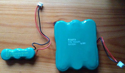

Reply 4 of 16, by Nexxen
I removed the sub-battery as it was already dead and bulging.
The plastic wrapping saved the system from bad leaking.
Sub-battery,
7.2V 110mAh
6/V110H Ni-MH
RTC battery is dead and I need to replace it,
3.6V 30mAh Ni-MH
3/V30H
Being Ni-MH batteries there's no battery hack possible and there are no EXT Batt pins.

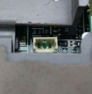

Reply 5 of 16, by Nexxen
The RTC battery plug on the m/b is corroded, leak travelled down through the cables to the plug.
The plastic plug can't be removed, but it came out shiny after vinegar.

Reply 7 of 16, by Nexxen
Battery replacement:
1) RTC
2)Sub-battery
I found several 3.6v but 20mAh instead of 30, is that ok? To me it's just going to last less. Same for sub battery.
Really need help on this.
Thanks

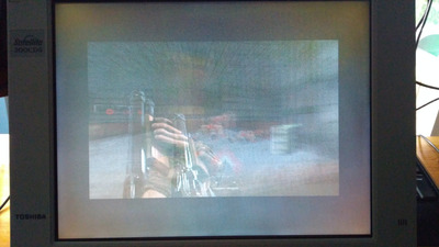

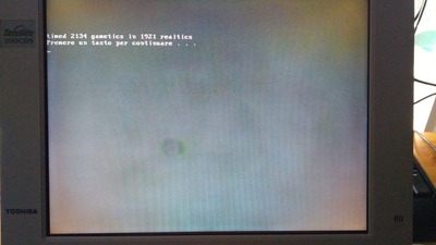

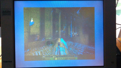

Screen:
"11.3-inch, Thin Film Transistor (TFT) color LCD with 800 x 600
pixels. The 200CDS has an 11.3-inch Dual-scan Supertwist Nematic (DSTN) color
LCD with 800 x 600 pixels. The built-in display controller supports 800 x 600
resolution with 16M colors capability and up to 1280 x 1024 resolution with 256
colors on an external CRT"
I have some issues with it,
quality is poor and black is not really black... see pics
We can see all the drawbacks of a DSTN screen. Unsuitable for gaming.
In 800x600 in Quake I get those blue artifacts.
Text quality is low and/or bad, but I noticed that before autoexec.bat finishes loading it changes from high text quality to bad.
Probably a wrong mode code prepare something. No code set and it displays letters perfectly.
Never had that before.
