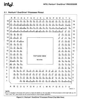

Obviously, the first hurdle is that my motherboard doesn't have a Socket 2 that is required for Pentium Overdrive, let alone Socket 3. It doesn't even have a Socket 1. It only has a hybrid socket that can hold either 486 PGA cpu or 387 FPU (in case a 386DX CPU is installed).
However, looking at the Pentium Overdrive pinout the extra row of pin doesn't seem to be at all essential. There is a number of extra power points and some signalling pins to support L1 cache coherency when using write-back. Nothing too much to worry about. Conveniently, the PODP doesn't use 486 WB cache controls like DX4 or 5x86 does, so the WB/WT pin remains floating and no need to configure the board for P24T like you do it on normal 486 motherboards.

As the socket wasn't designed for much wider PODP it helps to use a PGA169 socket to lift the wide CPU up a bit so that the unused row of pins doesn't interfere with jumpers and other components that are in surrounding of the CPU socket.

I thought there must be a reason for the PODP having the extra power pins. Just to play it safely I configured maximum power on my ATX2AT device and set the frequency to 25MHz. However, it turns out that idling only @ 3.6A - not too far from ordinary 486DX.
I wouldn't probably run it for extended period of time, but it was a successful experiment showing that all those extra pins on the PODP are only optional.

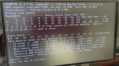

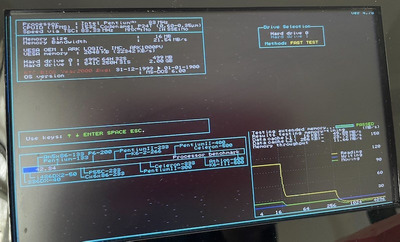

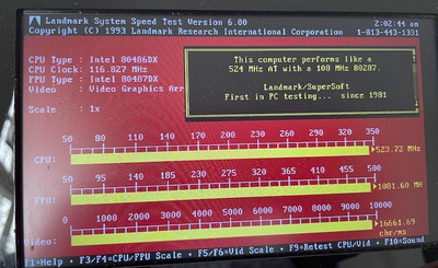

Performance @ 83 MHz has been rather disappointing so far.
The CPU performance is amazing, but L2/mem remains still @ mediocre 386 levels which is holding back the performance. Hope it can be tuned slightly higher. So overall it is a hair better than a 486DX2-66 on average 486 board.
Getting about 9fps in Quake and 27fps in Doom test (Phil's benchmark pack versions). The RAM speed is slow even to 386 standards.
I cannot tune L2 cache to run at 2-1-1-1. Will need to solder-in the missing filtering caps and use the native AMI BIOS (if you guys can post it it would be great).
Looks like at 83 MHz the PODP draws only about 4A at when running Quake, so not a big deal.
