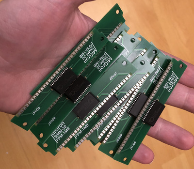

Done... 4 x 1MB = 4MB, 45ns, FPM, Simm-30 Memory Modules are now available.
I also managed to beat my 386 overclocking record with 0WS at 51.2MHz.
Video:
https://www.youtube.com/watch?v=VNtnxc0_SG8

Reply 22 of 47, by galanopu
Yep and easy to build and test.
That is why these modules are cheaper.
The only thing missing is the parity function.

Reply 23 of 47, by maxtherabbit
galanopu wrote on 2021-04-13, 11:56:
Bro what? 50ns is barely fast enough to do zero wait at 25MHz
Reply 24 of 47, by Tiido
Those 50ns memories have page mode cycle in the 20ns range.

Reply 26 of 47, by galanopu
If you mean 4 x 4M = 16MB. As I said in the video.
I will try to remake the 16MB ones and make more pieces this time.
The only problem is that I do not know the batch of the chips I will get will be.
Most top at 46-47 MHz with 0 WS. I can only guaranty this for the 16MB ones.
I always try to do the best I can with the shock I have.
If you mean 4 x 16M = 64MB.
Should be possible to make but not at these speeds.
Also probably a bit pointless as 386 boards do not support these.
and 486 M/Bs also have Simm-72.
I might do Simm-72 next (45ns FPM).

Reply 27 of 47, by Anonymous Coward
I did mean 4 x16MB = 64MB. If it couldn't be made at 40-50ns, there wouldn't be a point as 60ns is readily available.
There are definitely 486 boards that accept them. Though, admittedly it's more of a niche item.
Reply 28 of 47, by Deksor
What about making 72 pin Simms with these chips ? I have a 486 motherboard that can do 0ws on both reading and writing but even with 60ns simms, I'm limited and it doesn't take 30 pin Simms, only 72.
Reply 29 of 47, by galanopu
Yes exactly next goal is to make Simm-72s with these chips.
These will again be fast, but this is only possible at low capacities.
So probably 45ns, max 8MB per Simm module.
