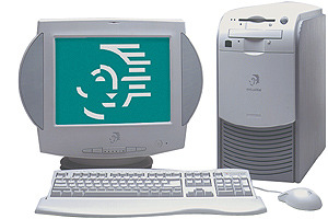

Personally I don't like the 1997-era PB full ATX cases, this one to be precise:
22.68 KiB
3243 views
It is however a fully standard ATX case that pairs nicely with Intel AL440LX. Here's a teardown of one (in French) http://passion-pb.fr/model_multimedia_xl_2413.php

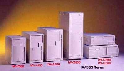

Personally I'd rather go for a retail InWin ATX case, something like this:
20.58 KiB
3243 views
I have a variant of the IW-A500 and it's a dream to work on and in (removable motherboard tray, nice separate side panels, all edges rounded not sharp etc.) and looks the period-correct part, even if I use it with a 1998 So7 MVP3 motherboard and K6-2 CPU.
