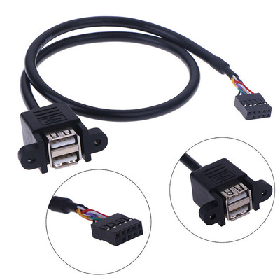

You can find cables that convert the USB headers on your case to USB type A and then route it to the back of your motherboard. I am using them now. Not the most ideal solution but cheap and easy.

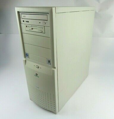

I have a Gateway E-4200 440BX system and I'd like to set up front panel USB and CF2IDE.

I purchased a cheap front panel cable:
60.78 KiB
1379 views

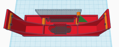

I made a quick and dirty CF/USB front panel in tinker cad:
243.86 KiB
1379 views
https://www.tinkercad.com/things/e5ZJt5fJTin- … with-cf-and-usb

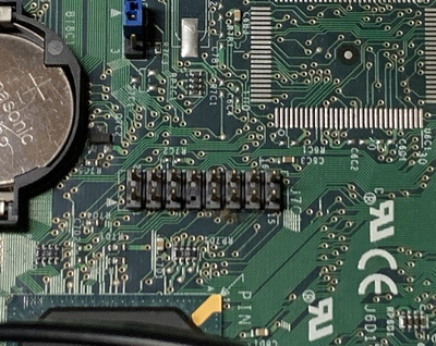

According to the manual, this is the front panel usb header:
122.52 KiB
1379 views
I have not found any diagrams that list the pin out for it.
Any suggestions for identifying the USB header pins using a multi-meter?

440BX... has only 2 usb 1.1 ports... so unless there is a additional seperate USB controller/hub on the board of that machine of yours, you can only use 2 ports, either front or back.
measuring with a multimeter should give some insight, continuity measurement for the GND and 5V pins, and maybe continuity measurement from the back USB ports D- and D+ pads to the pins of the front panel USB connector.
Seems like you should've made a separate thread for this... meh. hope the info helps.
