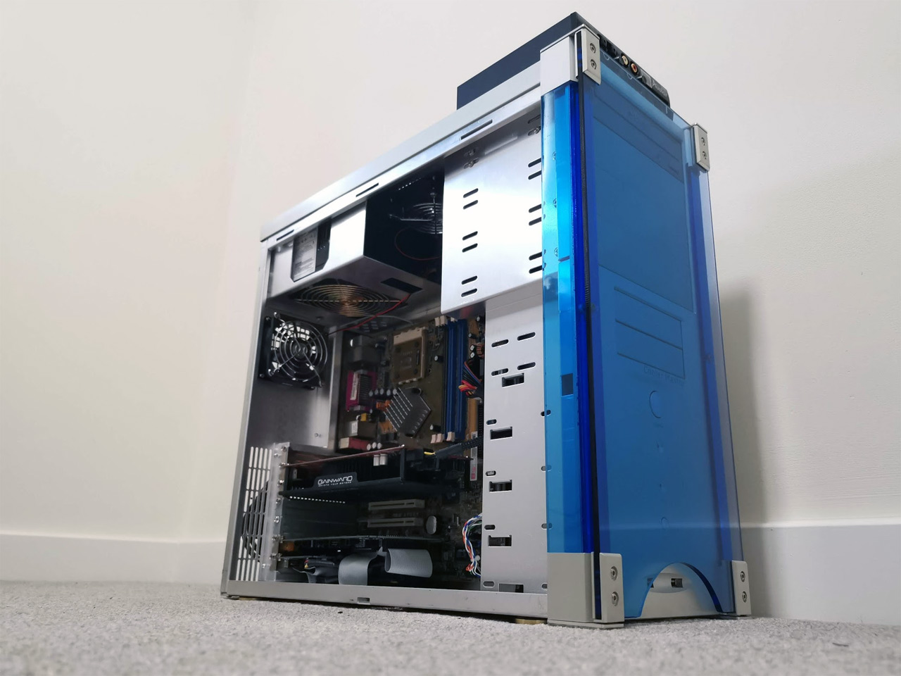

What's your objection to nForce2? Seems to fill a niche for me, I've got older machines to play 95 and DOS games, newer machines to play stuff from XP SP2+, which puts a nice Barton machine on nForce 2 right in that sweet spot for late 98/ME and early XP gaming.
Nothing at all wrong with my A7N8X machine!
