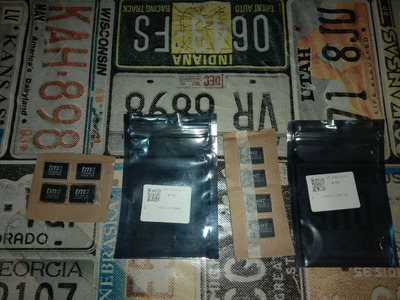

So I did my order through utsource.net, the first time I bought some MDRAM for my tseng labs card, a bunch of SOJ40 memory chips and everyone but one were working fine.
A month ago I did another order.
I bought some more MDRAM chips and some cache chips.
This is what I got:
178.2 KiB
606 views
Obviously noone of the chips has ever worked, they are just a piece of plastic, I suppose they just packed with some paper just a minute after they come out from the factory, as they claim.
Just to be on the safe side during the order I also paid the "Returns & Shipping Guarantee Policy" for 1 eur but despite of that i'm fighting with customer client support they claim they can't see the pictures of non working chips even if I attached them to my email and in a website too.
I paid with paypal lucky enough but i'm unsure they will side with me, what do you think?
Sorry for the vent, but it should also be a warn for retro lover like us to be aware when order from that shop.

How do you know that those are fake? Did you open them and test?
Not saying you are wrong, I am just interested in knowing how you determined they are fake.

Yes, the guy I paid for tested all 4 of them and when installed the board didn't boot, while once those were took off the board worked like a charme.
I needed just 1, I bought 4 because I knew there could be defective parts, but those are all fakes.
Also as stated I doubt they get out from the factory wrapped with tape and paper, that's not how the original stuff is sent out.

Contact UTSource and settle this issue. I think they bought from chinese sellers without checking the sources is the mistake.
Paper and cardboard is good ESD material, but tapes on components are not ESD. If sandwiched in paper or cardboard then bundle taped, that's acceptable.

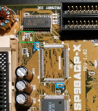

Am I right in assuming this is about the cache upgrade on that DFI motherboard?
If so what did you do apart from installing the second cache chip?
Asus motherboard, it was sold as with 512kb of cache and 1024, no other things are needed since the tag ram is already populated.

All you did was solder on the chip, right?
My reasoning is if they just sent you plastic with legs the board would probably post normally just with the same amount of cache as before; electrically nothing changed.
So either you got chips that are defective or just too slow for the board,
or you got completely different chips,
or they are the real deal but something else is wrong.
I looked up some pictures of the board. I assume you populated the pads directly next to the chip with the correct capacitors? Without them the chip will most likely not work right.
Also I think you need to move the resistor from R24 (one cache chip) to R23 (two cache chips).
I don't know wether this is all the difference between the 512k and the 1024k variant and I can certainly not verify wether my observations are correct at all but I believe it's still worth a shot.
If you're going to go for it I'm rooting for you! 😃

There isn't any empty spot for others capacitors, the board is fully popoluted, the only thing that are missing are 2 tiny resistors around the second cache chips.
If you mean the solder spots marked blue in the attached picture, i am pretty sure those are for capacitors. The values are the same as on the capacitors next to the other chip.

So what exactly did the board do? Did it turn on (fans spinning, drives powering up) but no beeps and no picture? Did it POST (count RAM, list drives etc.) but not boot the OS? Or was there no sign of life at all?
You did not adress the possible issue with not moving the resistor (marked green). From pictures online it appears the resistor is installed at R24 when only one cache chip is installed and in R23 with two cache chips.
Again, I am not saying those chips are certainly real and working. How would I know?
I'm just trying to explore the possibility of the problem being the result of an oversight in installing them.
Btw. since this was the original question it is my experience that PayPal sides with the buyer in 99% of cases. Usually you'll be required to return the item at your won expense though.
This motherboard specifically started to turns on as soon the atx power connector was plugged, that was already worrying.
Then it showed a black screen with fan spinning and so on.
Unlucky I can't remember what the debug card said.
Can you please reupload the pictures? They sure help me to clarify.
Thanks

I was referring exactly to those things, thank you for the clarification. I suppose it's worth a try but i'm not confident.
I should move the resistor from r23 to r24 and then add two caps on the pads near the cache chips.
Do you know how can I find the value for the caps?

Those are caps that provide a local "energy pool" for the chips in case they need a sudden spike of energy, and delivering it from somewhere else in the board wouldn't be fast enough. So the exact value of the caps doesn't matter that much. It's important that these caps have a low resistance, so they can deliver the energy with minimal "friction". Multilayer ceramic capacitors (MLCC for short) do a great job at this, so industry convention is to use 100nF MLCC capacitors. The typical size of SMD components on PC mainboards is called "0603".
