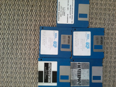

Reply 8 of 11, by Caluser2000
Can you not fit a 3.25" 720k floppy drive ,or a 1.4meg fdd acting as a 720kb drive, in the system in the system and use something like these stiffys?:

Reply 9 of 11, by BitWrangler
They'll take a 720k drive, but they don't have a twisted cable, so you have to set the jumpers/switches on the drives right. Also I think you need the edge connector to 34pin adapter. Used to come with a cheapie cheap 5.25 drivebay adapter kit in the day along with a 5.25/3.5 power adapter, not sure you can still get those... hmm, some ten dollar ones on evilbay.

Caluser2000 wrote on 2021-06-07, 00:28:
I don't have an adapter on hand to be able to use the floppy drives I have with the cable in the machine, nor a compatible addon card that I could use
