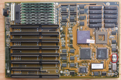

I have a strange issue on one a 386 system, I have swapped a i386 DX25 cpu and replaced it a DX 33, however the system bios still says it’s a DX 25. Am I missing something here ?

Yes, you're missing the crystal oscillator, which is located on the motherboard. 😀 Depending on your specific board, it might be easy to replace or very hard (since you have a socketed CPU, I suspect that the oscillator is also very easy to replace in your case).
Your current oscillator runs at 50 MHz (and the CPU runs at half that speed). You need a 66 MHz oscillator for a 33 MHz CPU and an 80 MHz oscillator for a 40 MHz CPU.
This is how an easily replaceable oscillator looks like on a typical 386 board:
