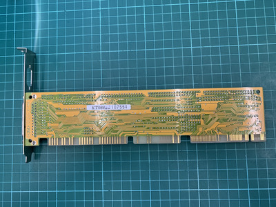

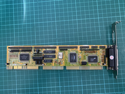

I'm collecting parts for a new 486 project and found this controller but I can't find any info about it at all.
Any help to identify would be appreciated 😀

I think it may have been made by Koutech from the sticker on the back.
The VLB IDE controller is maybe supposed to be good. See here for a bit of info:
https://www.vcfed.org/forum/forum/technical-s … 25vl01-poweride
http://www.ryston.cz/petr/vlb/adi2.html
