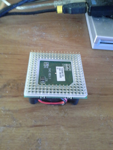

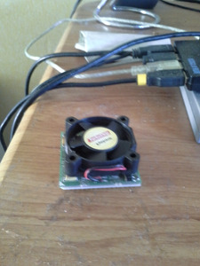

Reply 2 of 3, by Caluser2000
The 586 Hypertech HyperRace 586 is the same:

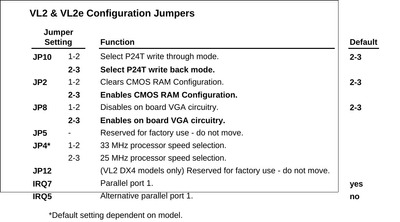

Reply 3 of 3, by yorik
Thank you very much for your answer. I found one of this devices.
Just a last question, on this motherboard, I have a wt/wb (write back/through) jumper. This have nothing to do with voltage I guess, it simply enables the feature WB that some cpu's have ?
