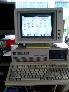

I run GeoWorks Pro on my 1987 XT-Turbo system with EGA moniter. Supports a large variety of video outputs.
    373.38 KiB
    124 views
