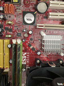

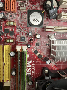

After perhaps too many inserts and removal of DDR2 sticks on the motherboard (MSI K9VGM-V), the system wouldn't boot with a stick inserted into DIMM1 (long beep just after booting). It would boot with a stick in DIMM2, in single channel mode.

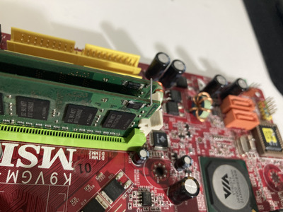

Visual inspection revealed that one of the tiny metal parts , third from the left and on the bottom, had broken and no longer provided electrical contact.
At first I thought it was hopeless and used the board in single channel mode (which in most normal use cases is only 10% slower than dual channel mode: https://www.anandtech.com/show/1598/3). However I thought of a solution to reestablish physical contact: by soldering a wire from the back of the motherboard to the DDR2 stick itself.
So first I identified, using the functional DIMM2 and a multimeter in continuity mode, the exact pin on the back of the board that corresponds to the broken pin. Then I soldered an AWG28 wire to the corresponding pin on DIMM1:

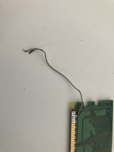

After that, the wire was soldered to the corresponding pin on the memory stick:

After putting the motherboard back into the case:
The attachment IMG_0014.JPG is no longer available
The attachment IMG_0015.JPG is no longer available
The board booted fine, but unfortunately screwing back that screw was a bad idea. I smelled some smoke, and the wire had burned and slit in half. I suppose the screw created a short with ground and thus caused the wire to burn:

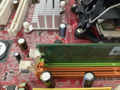

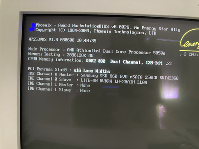

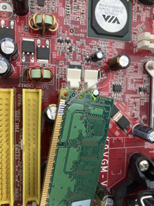

Fortunately I had quickly turned off the PSU as soon as I smelled smoke, and the board would still boot with the DIMM2 slot. So I thought maybe DIMM1 is still working, and proceeded to solder a new wire. The result:
The attachment IMG_0017.JPG is no longer available
The attachment IMG_0027.JPG is no longer available
So in the end this shows that it's good not to give up, even something that seems very difficult to repair at first glance (replacing the whole DIMM plastic holder would be next to impossible), with a bit of ingenuity a lot can be achieved 😀

Reply 4 of 10, by weedeewee
it's easy enough to look up the pinout and find out that it's the VCC SPD line, which supplies 3v3 to the little eeprom on the dimm.
Do not ask Why !
Reply 5 of 10, by cde
Thanks for the info! I could probably simplify the setup by taking 3.3v somewhere else on the dimm and powering the eeprom with it.
Reply 6 of 10, by weedeewee
I doubt there is any other place to get 3v3 on the dimm socket, heck it could even be a different voltage, like 2v5, but still the DDR2 voltage seems to be 1v8.
though I have to say, I haven't looked into it further.
Do not ask Why !
Reply 7 of 10, by cde
weedeewee wrote on 2021-08-15, 15:49:
Thanks to your suggestion, I was able to make a better repair by reusing the 3.3v from one DIMM to another:
