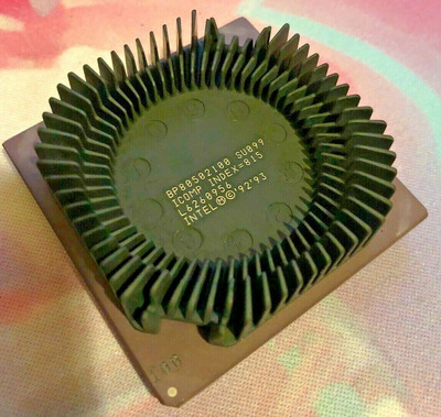

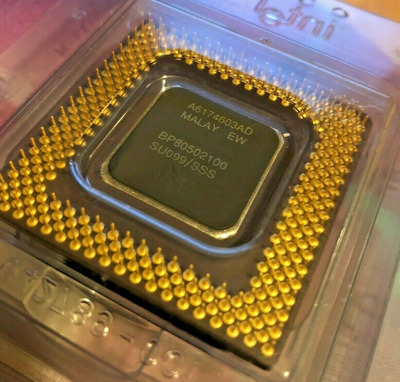

I bought a pentium 100, but when i put it in, before turning Switch 6 ON, it registered at 75mhz, so i thought the guy who was selling it didn't know what he had or it was one of those rebranded 75s which i heard about. I have to install it again now and check how it performs. Switches 7 and 8 were set to OFF by default, so I won't have to touch them and switch 6 will remain ON I suppose. I'll do this tonight, after work, and post the results.

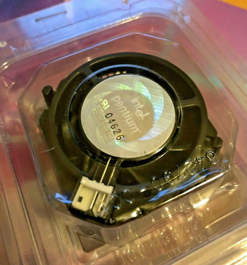

Reply 29 of 34, by john_popani
TrashPanda wrote on 2022-02-14, 08:14:
The background behind that text looks sketchy as all hell, some of the white letters are slightly smudged too, doesnt look real, neither do the markings on the bottom.
Exactly, it could very well be a rebranded 75 so i'll be on the lookout for another one, just in case. This one was simply too tempting to pass on, given it's brand new 😁

Reply 30 of 34, by TrashPanda
john_popani wrote on 2022-02-14, 08:50:
Well its reboxed, it may not actually be new.
Too many red flags on this one honestly, I would get another and uhh .. shuffle this one off to the Evilbay.

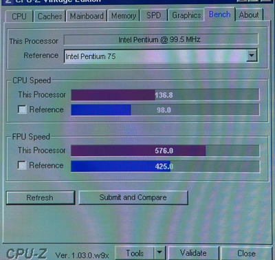

Er, these are vintage systems, nothing happens automatically. If you leave the jumpers at 75MHz, it runs at 75MHz, even if it's a 200MHz CPU. If you want it to run at 100MHz, you need to set it there.
Again, that is NOT the correct setting for a Pentium 100. It should be set to 1.5x66MHz, so 1/6 off and 1/8 on. 1/7 and 1//8 were off "by default" as the Pentium 75 uses a 50MHz FSB so were correct for it. Not for a Pentium 100.
It's premature to suspect the seller if you haven't set the board correctly for the CPU it is supposed to be.
I set the board as per your recommendation and the new cpu runs at 100mhz. The benchmark is also ever so slightly better than the original one with the overclock. So i guess i'll be keeping the new one. I managed to connect its fan to the power, so hopefully it's going to keep the temperature at a good level.
I'm going to try a new gpu as well, because some games are still running worse than i remember. It has an Ati mach64 now, which i'll change with an S3 Virge. It will be interesting to see if there's an improvement.
Thanks again 😀
