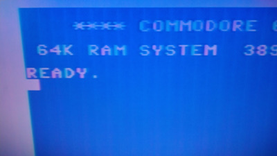

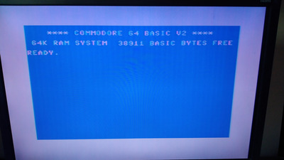

Hi all i have had this beautiful commodore 64 sitting around for a while now as it has this video output problem where you can see in the images that the output has this sort of rainbow effect across the screen.
you can see it in the basic text on screen. it seems to be where the jail bars go down the screen. i have been told that you can buy a luma fix for the video chip i have one of those in my other commodore computer but that was to fix the jail bars not a rainbow sort of problem.

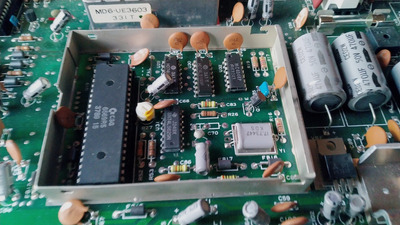

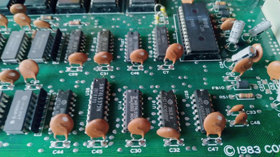

also in the pics you can see some of the capacitors have some white marks on them. not sure if this is normal or not or if they are causing the issue.
i recently bought a brand new video chip for the computer but it had no change on the rainbow effect.
the issue happens on all outputs s/video composite and rf.
aslo the computer itself is 100% working with no issues with software or anything the video output is the computers only problem
if anyone know if this is an easy fix or not please let me know.
or if a luma fix would fix this issue thanks all

In essence, this: https://github.com/tebl/C64-Modulator-Replace … ator_simple.png
This is just a part of the original C64 circuit inside the modulator box. I strongly suggest getting rid of composite mixing, so at minimum C6 should not be populated. This will let you have pure luma on composite output and easy way to add chroma back if you need it. Better yet is to disable composite entirely and get rid of C6, R8, R11 and possibly L2 (though L2+C4 might have some other benefits like better rejection of harmonics for luma - so in my own circuit I left it be).
Reply 11 of 31, by vkcpolice
so if i take C6, R8, R11 out of the board i will still have svideo?
Reply 12 of 31, by Deunan
Yes. In fact if you take all of those out then S-Video will be the only thing you'll have. If you want to try and mod the modulator then you can either remove (actually, just lifting one pin is enough) C6 or R8, that's the minimal change required to disable mixing of the luma and chroma signals. This alone should greatly improve S-Video output, if it does not then perhaps your C64 also needs other mods in the video chip output filter circuitry. But if it does work then you can decide if it's good enough or if you need remove the rest, or even replace the modulator as a whole.
A word of warning, this is a diagram for one version of the C64, there were some other modulators in there too (depending on the mobo/video chip). In general the layout and inner workings are the same, but part numbering might not be, so make sure you are removing the right part. Preferably desolder it without damaging in case it needs to go back. Also this particular replacement amp, as many others on the net, is kinda broken. The author left the D1 diode in but removed the power bypass capacitors - there's one electrolytic and one or two ceramics plus a choke, but that choke is not requied without the HF part of the modulator. The omission is most likely due to these parts being drawn as part of the HF section of the modulator, so people just cut that away and also end up removing power filters. If you end up building your own amp I'd recommend looking at original schematics.
EDIT: Ah, one more thing. It seems many modern TVs don't like the pretty high drive of the chroma signal that this circuit does. I changed that for my own amp, basically replace R4 (68 ohm) with 180 ohm, and R5 (220 ohm) with 150 ohm. These are the values I went with and I'm pretty happy with the results.

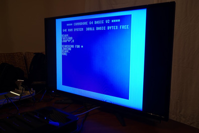

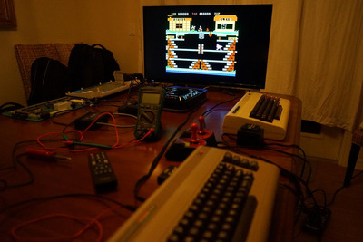

These photos are back in 2015 when I was restoring a slew of C64 and VIC-20s. As you can see, the image on that LCD TV is crystal clear with no modifications made on the Commodore systems themselves. Used a composite A/V cable I bought on Ebay.

Um, does that screen use a scaler maybe?
On my b/w tv from the 70s there is noise, with vertical stripes (using the stock RF modulator box). 🙁
Reply 19 of 31, by liqmat
Jo22 wrote on 2021-10-26, 17:48:
liqmat wrote on 2021-10-13, 20:51:
I don't have any of that anymore, but this is the model.
Paired with one of these.
It was a crystal clean image.
