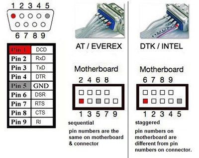

So having recently got DOS622 installed on a 1gb CF card on the SOYO 4SA2..I wanted to add mouse functionality..
You'd think that was straightforward...and it usually is.
I borrowed a working MS serial mouse from a working 386 system...
Plugged a rear panel 9 pin serial port into the serial port 1 header on the mobo and inserted my MS mouse 9.1 floppy in the drive...
It refused at mouse not found ?
I went into the bios and set serial com 1 to auto ...just in case..
Ran up checkit and tested the port..everything passed ..except test modem status...no surprise there.
The serial mouse still connected at this point.
I checked the orientation of the 10 pin header on the mobo ..in case I had it in wrong...referring to the manual.
That was OK...
Neither Checkit nor The MS mouse installation can detect I have a mouse connected ?
This is basic stuff ...but I'm confused.
The mouse itself works on another PC ...The COM port checks out in Checkit..
The ribbon 10 pin to 9 pin serial lead is brand new old stock..?
Any suggestions appreciated.
I could set the com port manually in bios ..
but is there a specific config expected by both checkit and MS mouse 9.1 ?
probably something basic and I missed it ...but I dont usually have problems with mice...

Reply 1 of 24, by konc
Did the ribbon come with the motherboard? Not all serial connectors on motherboards and I/O cards have the same pinout. There are mainly two common pinouts, maybe your ribbon/connector is not suitable for this motherboard as it is.

Reply 3 of 24, by weedeewee
for your information...
two possible mainboard to DB9 pinouts
    57.3 KiB
    980 views
    mainboard serial DB9 pinout

Thanx for the pinouts Weedeewee...
I'm going to have to make at least another clone of the one I have that works..
I have about 10 of these cables and only one works with the Soyo..
I hope this helps someone else out...because I for one was unaware they were not standard.

Reply 6 of 24, by weedeewee
Vipersan wrote on 2021-10-17, 14:10:
Someone else posted it here on the forum... after which I reposted it to another thread, where someone noticed a fault with the original, (the pinout names meh)
So this one is with the correct pinout names... I hope 😀 It's always tricky to find good info and since host and device can have different perspectives. oh well 😀

Just looked at my db9 from a 440gx board (late 90's) , and it's the sequential staggered approach
older pentium1 mb cables, also sequential
anyway, measuring where the ground pin db9 pin 5 goes to on the cable should give you an indication and measuring which pin is ground on the mainboard gives you an indication if you have the right cable or not.
the more i look at that picture, the more i want to change it and remove a lot of words :-p
edit: I keep mixing up the two. one preserves the pin numbers on both sides, the other does not. I like the one that preserves the pin numbers. Argh.

Reply 18 of 24, by Tiido
maxtherabbit wrote on 2021-10-17, 15:50:
If any words need to be excised from that image, they are 'sequential' and 'staggered'. Highly ambiguous
I think I am the one who came up with these some years ago, before I knew there were the AT and Intel names 🤣.
I only ever discovered it when suddenly a COM port mouse stopped working... eventually I found out the shorter and neater COM port breakout I changed to had a different pinout, something I didn't know was a thing until then. It made the most sense to me, one has pins going 12345 6789 on DB9 end, and other 13579 2468, one is sequential, other is staggered... Easy to tell when you lift back the shroud on the DB9 side and that's where the naming came from.
I see seq on almost all my 486 and older stuff, while Pentium1 stuff is almost all staggered, and all newer stuff always staggered, I have even taken time to write a designation on my breakout cables and mobo headers so that things wouldn't be mixed up again. I have an (un)healthy mix of both available 🤣
