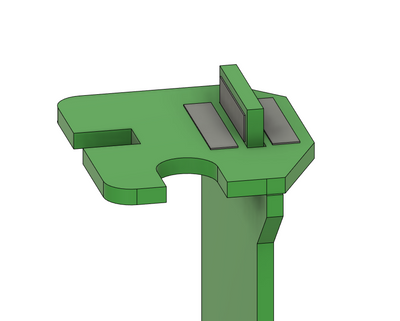

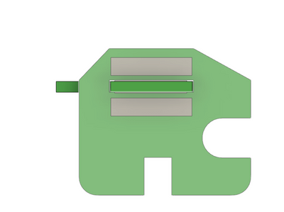

Reply 140 of 231, by CalamityLime
(quick edit)
There's the general idea and the files.
Key'd so the user shouldn't put the pieces together wrong. Should be mechanically good for a panel mount socket cutout or something.
I added some random amount of clearance in the hole for that slight rounding you get with milling.
I'd guess that you could press the two together and fiction would hold it together while you stick it together properly.
I didn't add the vias so the in the files still just has pads because it's too late for anything else right now and I want to go to bed.
Better or nah?

Reply 141 of 231, by Sphere478
Pad on the back underside also?
Sphere's PCB projects.
Reply 142 of 231, by CalamityLime
Sphere478 wrote on 2022-05-27, 02:10:
I suppose why not.
This was just a quick edit to show the idea. I didn't edit the pads or foot prints for it.
edit: keep in mind that the images are taken in Fusion. I export the step files from kicad and import them into fusion so they can go together but the export doesn't include the pads so I added a basic shape in Fusion to where the pads are in the kicad.
Be Happy, it's only going to get worse.
- Projects
Limes Strange 3D models
USB-2-232
Reply 143 of 231, by Sphere478
I’m thinking that small tabs give a stronger cross section because of where that screw notch is.
May be over thinking this but that’s half the fun, figuring out how to make the best way possible 🤣
Eh, on second thought both ways is fine, but adding a third side seems like a good idea. Also plated edges
That pad may be too close to the screw.

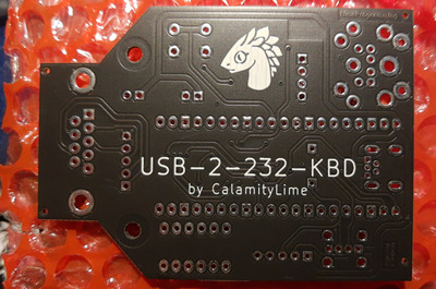

Reply 152 of 231, by CalamityLime
Hello!
It was long put off but I've finally ordered the PCB's from JLC with assembly. I ordered 10 since the price difference between 10 boards and 5 boards wasn't even a 10'er
I've checked and doubled checked and I'm pretty sure my circuit is correct for the parts I've ordered.

Reply 158 of 231, by CalamityLime
PCBs arrived!
- Projects
USB-2-232
Reply 159 of 231, by Sphere478
Very nice.
I really like that bendy/teardrop trace plugin you are using.
