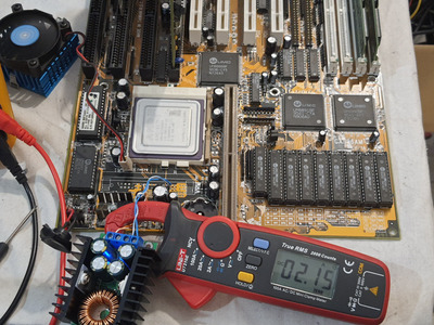

I had a bit of free time recently and decided I want to do some experiments with my UMC Pentium board which I got recently, a Gigabyte GA-586AM.
https://www.ultimateretro.net/en/motherboards/2729
On the PCB I noticed what looked like footprints for a possible VRM upgrade, which would've given the board dual voltage rails for a Pentium MMX presumably.
So I did the right thing, desoldered the bypass wire from the Vcc2 rail (Vcore) and added my own DC-DC step down converter instead, which I set conveniently at cca. 2.2V

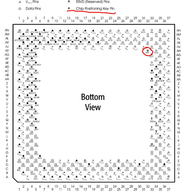

There was one more challenge though: the K6-2 wouldn't fit in the socket, one corner was floating. Upon further investigation, I learned K6-2's only fit in Socket 7 because there is one extra pin in one of the corners.
Checking the datasheet reveals that pin is used just for keying, which is normally a good thing, you wouldn't want to send 3.5V on the core, it would probably fry it 😜

For the conditions of my experiment, it was safe to remove the pin from the CPU, I had set up an appropriate VRM.

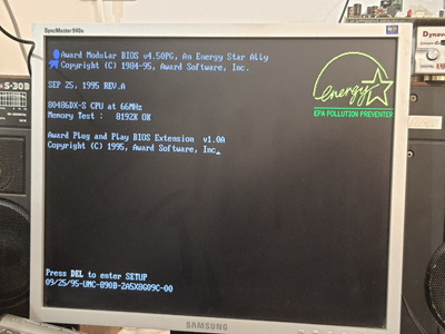

And after a power switch flip, it came to life!
1.28 MiB
451 views
Because the BIOS is so old on this board, there was no chance it would have K6 microcodes, therefore it was detected as a 486DX-66, which is funny.

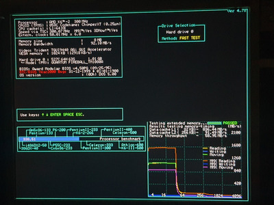

After a bit of playing around, I was able to get the K6 running at 300MHz (50FSB x 6), anything faster wouldn't POST.
Still, the results are pretty impressive for a Socket 5 board.
1.68 MiB
451 views
Moral of the story: you can run a K6-2 on Socket 5, but make sure the board has separate power rails (you can check with a multimeter).

Mainboards with a VRM-socket or prepared for a VRM-socket are always wired for dual voltage.
Sometimes there are jumpers to be removed to enable split voltage operation, on some boards a trace on the backside has to be cut.
What about (carefully) drilling a 1 mm hole in the socket for socket 7 CPUs?
