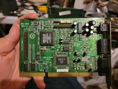

Back to the 486, I have a sound card with a true IDE socket, and I get the same behavior there. Is it possible this board just isn't compatible with anything large?

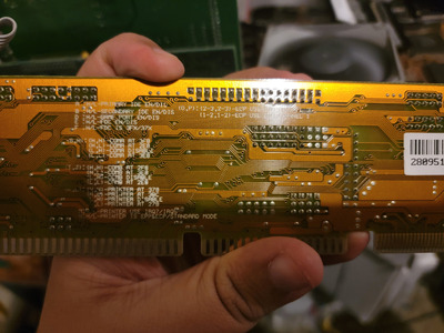

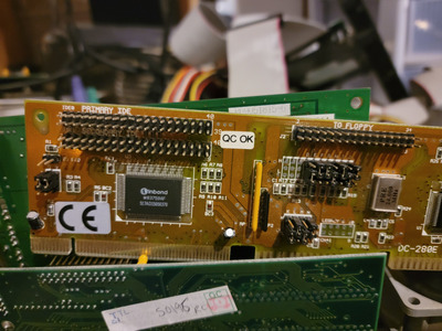

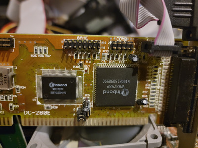

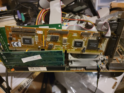

And I've attached images of the sound card and the VLB I/O board.

    Soundcard

    WinBondBackJumper

    WinBondClose2

    WinBondClose1

    WinBondVLBBoard-full
Reply 4 of 9, by Horun
That is a Tekram DC-280E VLB card, they are fairly decent. Here is the archive of the FAQ for it: http://web.archive.org/web/19970606090525/htt … am.com/FAQ.html
My guess is that the BIOS limitation of DOS 504Mb (528Mb) is why any card larger than your 256Mb will not work. Have you tried making the 1Gb CF with only a 500MB "C" partition using your P4 ?
