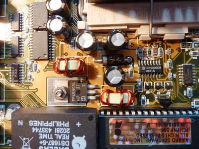

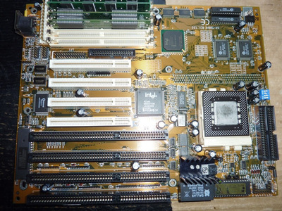

I recently found a GA-586HX (early revision 1.53) in very good condition. So I started experimenting with different CPUs.

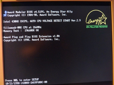

To get a Pentium MMX 233 running the latest BIOS (2.9) had to be installed. Then I did the "BF0 mod" to pull up the BF0 pin to Vcc when the DIP-switch is open.
253.13 KiB
1818 views
This worked well and the CPU is being identified by the BIOS correctly, the multiplier setting x 1.5 is interpreted as x 3.5 and the automatic voltage detection makes the VRM-transistor deliver 2.9 V core voltage.

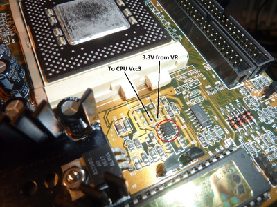

While I was looking for a Vcc3 pin at the CPU for the BF0 mod I found the voltage to be at 3.3V but there´s no direct connection to the 3.3V regulator at the upper-right corner of the board!
So where the hell does the 3.3V I/O-voltage for the CPU come from?
283.33 KiB
1818 views
I just found the answer myself: If Jumper JP4 is present (and no automatic detection for Split-Voltage CPUs and Core Voltage) JP4 is jumpered so that there´s a double bridge between 3.3V from the regulator and the Vcc3 pins at the CPU socket.
With automatic detection - which is the case here - JP4 is not populated and the 3.3V I/O voltage is switched by the semiconductor In the red circle (probably a MOSFET) by the BIOS autodetection circuit.
224.67 KiB
1805 views

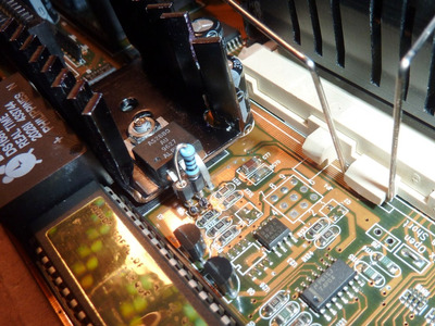

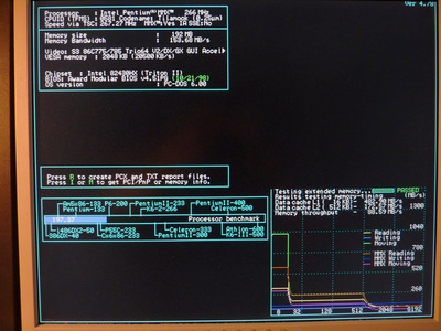

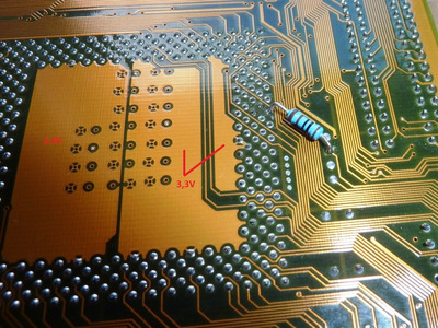

After the MMX233 was up and running it was time for the Tillamook 266.
There are just two tweaks necessary to get it running on this board:
1. To adjust the core-voltage to 1.8V a 100R resistor must be placed in parallel with R127. I soldered a small 2-pin connector in this place so resistors can be adapted to different CPUs / core-voltages.
2. Multiplier x4 has to be enabled by bridging CPU Pin "BF2" with Vss.
Once BF2 is active the Tillamook won´t respond to ANY changes at BF0 and BF1.
202.46 KiB
1707 views
The voltage regulator now has to dissipate the heat of a higher voltage drop, 5V - 1.8V = 3.2V instaed of 5V - 2,8V = 2.2V when a regular MMX is present.
But there´still less heat generated in total since the Tillamook´s core draws far less current.
120.77 KiB
1707 views
153.55 KiB
1707 views
159.57 KiB
1707 views
It´s a pity you´re stuck at 66MHz FSB here (unless the clock-generator chip is replaced) plus you´re limited to x4 as maximum multiplier.
Here´s a patched BIOS that supports harddrives up to 137GB and AMD K6-2+ and 3+ CPUs.
http://www.ryston.cz/petr/bios/
I will try this BIOS next, maybe a K6-3+ can run @ 6x66 = 400MHz then?

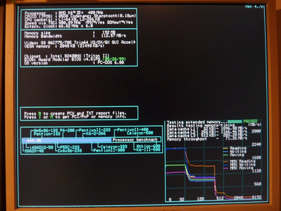

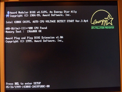

I tested this BIOS, AMD K6-2+ and -3+ are being identified correctly, they can even be configured to run at 400 MHz.
I just tried with a K6-III+ 450 (1.7V core that is quite happy with my current 1.8V setting):
114.62 KiB
1676 views
148.54 KiB
1676 views
Now that´s a great score!
I don´t think you can push the trusty old Gigabyte GA-586HX (1.53) much further without modding the clock generator for 75 MHz FSB.
The core voltage regulator is stressed much more with a K6-III+ compared to the Tillamook.
A much bigger heatsink or - better - a step-down (buck) regulator would be the perfect solution.

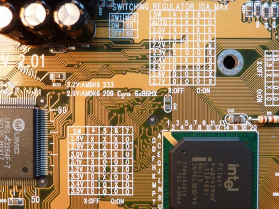

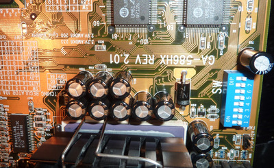

Maybe it´s a better idea to try a clock-gen mod with a GA-586HX Rev. 2.01.
It has a stepdown voltage regulator for voltages down to 2.0V already onboard so K6-2+ and K6-III+ CPUs can be used out of the box (without the need of enhanced cooling for the linear regulator).
440.26 KiB
1484 views
231.76 KiB
1484 views
In the Intersil datasheet for the HIP6008 you can find a nice ready designed application:
86.79 KiB
1468 views
The clock generator section seems to be the same - it uses the same Phaselink circuit but without tho option to use manual jumpers insted of the double switch and without options for 50 MHz and 55 MHz:
505.05 KiB
1484 views
Without modifying it you´re restricted to 66,6 x 6 = 400 MHz which is a pity. At 83,3 MHz FSB the CPUs could operate at 500 MHz.
