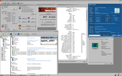

Reply 3 of 3, by agent_x007
Just FYI : That "GF8 Win98 support" comes down to just adding IDs into .ini.
It cannot make card work properly in any meaningfull way.
Also, it can also very easily make your installation of Win98 unresponsive.
DO NOT install it, unless you are ready to lose Win98 installation.
There is R_Loew patch that fixes some thing with 512MB VRAM NV card.
Also, PCIe cards (like PCX/GF6) work fine under Win98.
GF7 require hacked/moded driver, but also work.
My explination about memory tweaking where gpu card has 512MB vram the system should have 1024mb base memory PLUS double the O.S. minimum base memory to run.
100% NOT how things work. Especially on PCIe.

There may be a seperate limit per process (for example 2GB), but that's for OS sanity as Win98 wasn't designed to work programs that require such "vast amounts of system memory".
