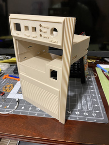

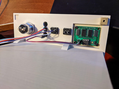

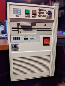

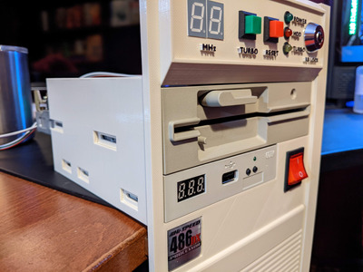

Reply 20 of 81, by wiretap
Fit of everything on the latest revised panel. Drives aren't screwed in for the picture, but they have perfect alignment when screwed in, with minimal gaps to account for various manufacturers that deviate by +/- 1mm from the standard.

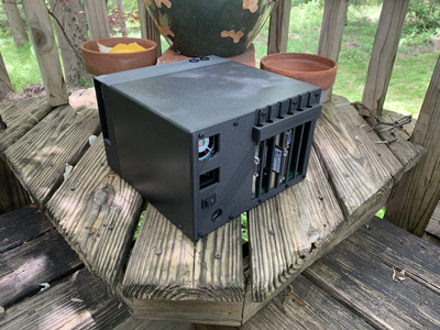

Reply 21 of 81, by ajacocks

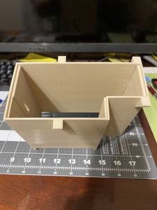

This really is impressive. I created my own PC case a couple of years ago, but this is a lot more complex and flexible:

I have published my model on Printables:
https://www.printables.com/model/31795-micro-at-case

Looks good !

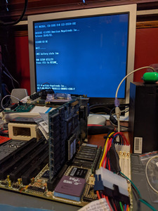

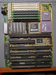

Fixed the PC Chips M326 v5.2 386 board yesterday. I think this one is going in another spare AT case I have laying around so I can keep the 3D printed case smaller with a 486 SBC.
Had to replace the AT power connector since the 12V was corroded badly from the varta battery. Fixed some traces in that area, fixed another trace over by the 74F244N chip, and replaced the corroded AT keyboard connector.

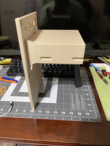

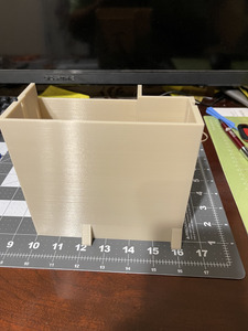

Reply 39 of 81, by wiretap
I drew up a quick u-shape case that mounts to the cube mounts.. we'll see how it fits once it is done printing. I already realized one slight screw up in the mounting hole positions, but they can just be filed easily. I'll fix them in the Sketchup/STL file once I see how everything fits. Should be done printing tomorrow night 🤣. This will be my tallest print, at 275mm. Hopefully no spaghetti since it is like half a roll of filament. Haha
