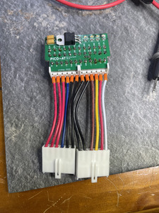

Reply 142 of 156, by ajacocks
Ohhhhh!
That explains it. That didn’t occur to me, -at all-. I generally assemble with my multimeter, and the negative voltages led me astray!
Here is my solution to the P8/P9 AT connector problem:
1.69 MiB
1395 views
I used the AT connectors from one of the cheap-o no-negative rail ATX to AT adapters. If you use ferrules on the end, they insert and stay nicely in the connectors on the PCB, once crimped.
- Alex

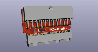

Reply 149 of 156, by wiretap
Have no fear... softpower version. That little Maxim IC fits perfect.
https://github.com/wiretap-retro/PICO-AT-Powe … apter-softpower

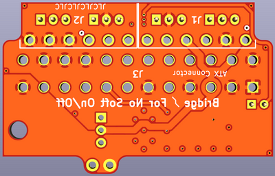

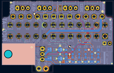

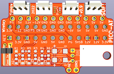

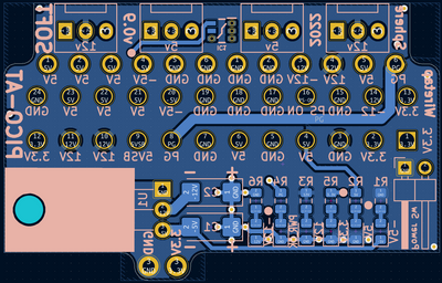

Reply 150 of 156, by Sphere478
71.26 KiB
1243 views
PICO-AT-high-current Soft 0.9.zip
1.96 MiB
56 downloads
Edit: added screw clearance on 3.3v plane (not shown in pics)
    173.61 KiB
    1180 views
    140.47 KiB
    1180 views
    323.05 KiB
    1180 views

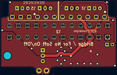

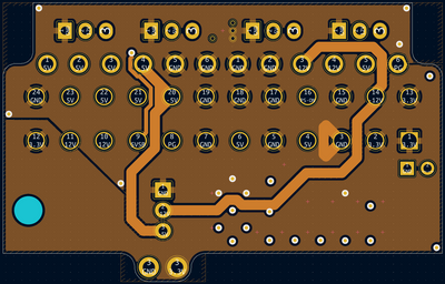

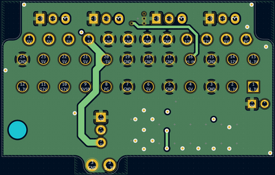

Reply 151 of 156, by Sphere478
layers
    224.47 KiB
    1179 views
    172.94 KiB
    1179 views
    160.25 KiB
    1179 views
    151.75 KiB
    1179 views
Sphere's PCB projects.
Reply 152 of 156, by Sphere478
This version has clear markings indicating ground as positive for those capacitors btw. so hopefully no more esploded tantrums. 🤣
Also, as you can see I added the device that wiretap discovered also 😀 thanks Wiretap!
BTW:
I have a request about the previous versions that I have uploaded. Please don’t order them anymore. They are nice to have around incase I need to check something or copy/paste something but don’t order them anymore. This goes for the latest one if it has been superseded also, (check future posts) if you already built one that is fine though. 😀
Please use the latest version if you use one of the ones I made.
If you use wiretap’s versions. Ask him what to do. 😀
In general you should use the latest version. Not sure why people in this thread are ordering and building older versions.
I have made the latest fully backwards compatible. You need not populate all its features. It is able to function in any configuration.
