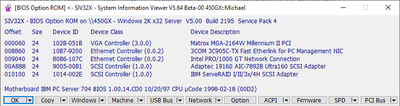

Reply 13 of 19, by red-ray
How about a Matrox MGA-2164W Millennium II PCI?
I just checked what a 450GX based IBM PC Server 704 had and the BIOS Option ROMs were as below.
file.php?id=132675
