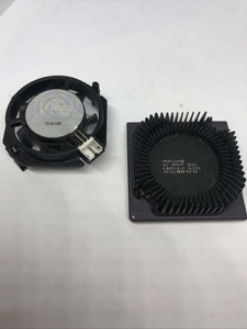

Hi
My heatsink is falling aprart.
I don't know what thermal paste was used.
    159.98 KiB
    1329 views
Reply 1 of 27, by debs3759
Whatever paste was used, there's WAY too much of it! It should never be on top of the electrical connections.
Can't see the damage to your cooler from that pic though. If it's a metal paste, it's not compatible with aluminium

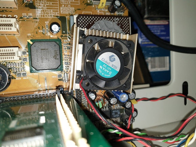

Reply 2 of 27, by aaron158
most socket 7 slots have the same clip spots that latter socket 370 p3 sockets had. if yours has those clips u could just get a socket 370 heatsink and clip that on they can be had for pretty cheap then u can just use any old thermal plate.
if yours don't have the clip though then u would need to look for some stuff called thermal Adhesive MG Chemicals makes some it comes in a 2 tube system 1 had thermal compound and another with strong glue. isn't cheap either like 30 for a small tube.
Reply 3 of 27, by Tetrium
Doesn't your CPU socket have those tabs that you can latch the clamp of the heatsink to?
What you're showing looks like it's not meant to be used in this fashion for a prolonged period, but looks more like an emergency repair?
I'd suggest you get another s7 HSF as yours seems to be missing some part that prevents it from being mounted. If your HSF came this way then I'd still suggest you get a different one but first you'd need to check if your CPU socket has those tabs at the side. It's unclear from your pic due to the angle but yours seem to be missing?

I don't even use past on my 233MMX, just a 1.5inch tall socket 7 heatsink (it is quite a tight fit). No overheating problems, been working like this for over a decade. I haven't ever used paste on any 486 or P1 cpu, just the clip heatsinks.

You'll achieve several times the advantage of any high end thermal paste by simply using a slightly less primitive heatsink without any goo on it.

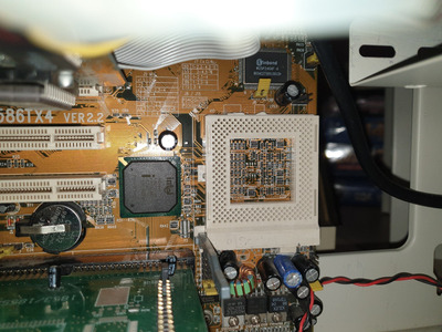

Reply 7 of 27, by idan182
This is how my motherboard looks like
Is the socket broken?
Can I attach the retention clips? I don't have any.. need to buy

Reply 8 of 27, by aaron158
the clips are broken. if your good at soldering u could probably remove and replace the socket. but other wise u will need a thermal epoxy. or find a p1 chip with the heatsink pre glued on most of the retail ones came with the heatsink pre attached to the chip with glue.

Reply 9 of 27, by Joakim
I fixed a socket 7 socket by gluing the clip back once. I guess it can be worth a try if you can find the plastic piece. In the case somewhere. I used a cyanoacrylat glue but there are probably better ones.
Reply 10 of 27, by weedeewee
idan182 wrote on 2022-03-20, 17:26:
yes, the socket is broken, as in, three of the clips are broken off.

Reply 12 of 27, by Tetrium
It's definitely broken. Both of them actually, never seen that before.
My guess is that (one of) the previous owner ripped off the previous heatsink with some brute force. Even breaking one of them (usually the middle one) takes some serious force and is uncommon, especially uncommon for socket 7 since the heatsinks which need to be mounted on socket 7 are rather small and the latch requires little force.
That or a previous owner tried to mount a HSF with 3 holes in the clamp (perhaps an Athlon HSF) on a CPU which was too high or used excessive force.
To be honest, I never even seen all of them damaged in this way.
It's not an easy fix. Either you find some way to install a CPU which doesn't require a cooling solution which requires those tabs, replace the socket (not at all easy and beyond my abilities) or alas get another board.

Reply 14 of 27, by Cuttoon
sorry if that's old news - didn't read through all the previous replies
those broken off bits of the socket, that's just wrong. Who would do something like that? A miracle the board survived such abuse.
But, there's a rather commons solution of fixing the heatsink to the CPU:
https://www.pimfg.com/product-detail/COOLER-1000
Unfortunately, I've only ever seen it applied to 486s, those being 45 x 45 mm, but the vanilla pentium is 50 x 50.
So, just putting that principle out there - 486s didn't mind, neither would Pentiums - If it's to be found - mechanically, perfectly sound solution.
There also ist the "diagonal wire clip" paradigm of heat sink mounting, like that:
https://eclats-antivols.fr/531-thickbox_defau … sor-cpu-fan.jpg
https://eclats-antivols.fr/en/ventilator/3494 … 0329415433.html
- which would make use of the one reamaining nose on your socket.
Might be possible to improvise the other with epoxy and a prayer.

Reply 15 of 27, by Sphere478
The diagonal clip may still work, I can’t find a pic but it’s a wire torsion clip you might be able to make. there also are options that clip directly to the chip it’s self. And the athalon clips use three notches.
Micron has a screw on one that clips to the processor it’s self and screw tightens.

The "diagonal wire clip" (I used to call it z-wire clip, for lack of a better word) won't work as there are no socket tabs on the CPU socket left to attach it to.
I'm not sure the clamp-directly-to-the-cpu-using-2x2-of-those-tiny-plastic-clamps CPU HSFs were ever made for s5 and beyond. These definitely existed for s3 and perhaps s4, which both would be incompatable with s5/s7 due to s5/s7 CPUs being larger (except for the s3 POD of course).

Reply 18 of 27, by waterbeesje
Alternatively I've successfully used those steel-plastic wires from thrash bags. Just make sure the plastic is not damaged.
I know, it's not bulletproof and some may think it's questionable but the plastic is not conductive enough to cause problems.

Reply 19 of 27, by Hoping
It just occurred to me that maybe you could try strapping the heatsink to the processor using a fishing line, I think it's thin enough that the pins on the processor are still making contact with the socket and non conductive.
Many people attach fans to graphics card heatsinks using zip ties the same way.
Also if I'm not mistaken you have a swollen capacitor below the socket.
