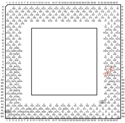

So here we have socket7 (this, I believe will work also on socket 5, though most, or all the chips that use these higher multipliers won’t work on socket 5 because of the single plane voltage.)
And here are the locations of the famous BF(x) pins:
The attachment 1B66BE87-F1DE-4654-ABAC-AAEB894D0990.jpeg is no longer available
I need to understand how these multipliers are programmed.
pull up?
pull down?
open ?
Do they accept one, two, or all three of those signal types?

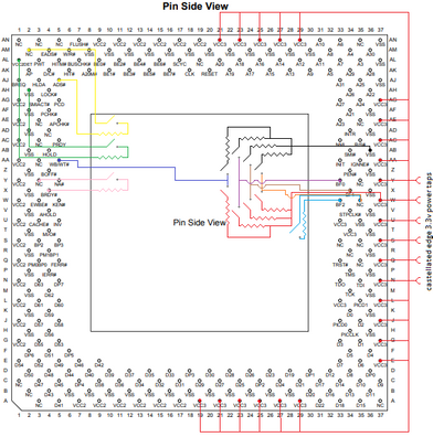

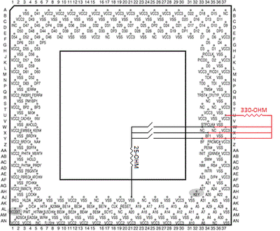

Reply 2 of 115, by Sphere478
The attachment 803CC0C4-2F2A-42EF-9740-36A7AF19524C.gif is no longer available
okay, I think I got it
how's it look? that look right?
of course any vss or vcc pin can be substituted for one another (respectively)
Edit: I’m a dumbass and connected them all together.. 🤣
Sphere's PCB projects.

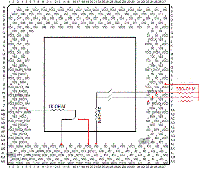

Reply 3 of 115, by Sphere478
I updated the diagram top show the WB/WT mod also. (from K6-2/3+ Success on Asus P5A 1.06 - simple mod)

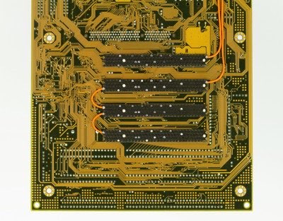

This gets me to thinking, maybe we could make a small pcb that we can solder on the back of the board with little dip switches and smd resistors on it
Kinda like this Re: Adding 3.3v to pci
Btw, we may be able to change the resistor values on the bf mod to 1k and 10k or 100 and 1000 I suspect that the low values I saw on the kingston aren’t as high as will work. And higher is better, (safer) one might assume that values that work for wt/bw should also work for bf

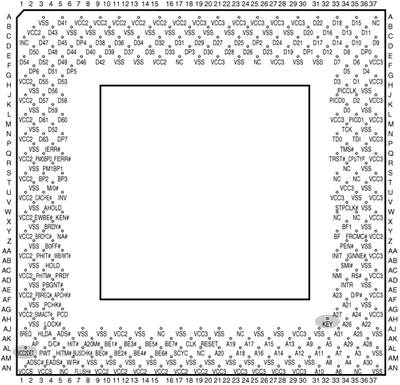

Reply 4 of 115, by Sphere478
Are there any other mods that could be added to this theoretical pcb?
https://www.pchardwarelinks.com/586pin.htm
Description of pins
Seems there is some image quality loss on the modified image, so here is a
Higher res pic:
The attachment 2D48BF41-3962-45F5-81C0-F971760BB8F0.gif is no longer available
KEN#, CACHE# Cache pins may be for enabling or disabling cache. It could be added.
SMI#, SMIACT# could be used to set SMI (No Idea of this would help with anything)
BHOLD, idk if this can be activated by a pin but some mobos have a special bus option for cyrix chips.
There are several things listed for dual processor functions on intel,
One in particular interest. Is how might we be able to set redundant processor mode. Perhaps by enabling of a signal on one of these pins?

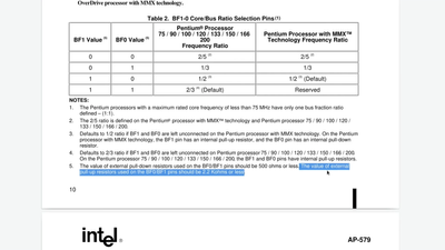

Reply 5 of 115, by Sphere478
The attachment F726632B-A95E-4F20-BE88-7C1C4747FF52.png is no longer available
Catsay shared this^
So pull down should be 500 or less
And pull up should be 2.2k or less

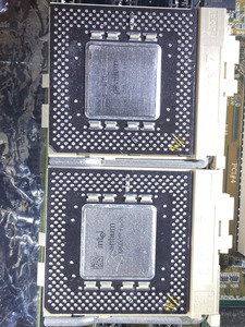

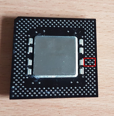

Reply 6 of 115, by Sphere478
ilembitov on discord just used the guide to do this to a pentium mmx 😀 and says it’s working.
It appears they are pulling bf1 to ground which should be relatively safe, but a higher ohm resistor may have been another approach that may have safety benefits. (The kingston used 25-ohm, the intel doc recommended 500 ohm or less for pull down, where as the kingston pulled up with a 330 ohm and the intel doc said less than 2200ohm )
The attachment 6D205353-A33D-4A3A-B62A-DF78EF582D66.jpeg is no longer available

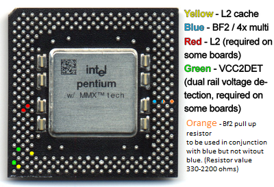

I also re did my tillamooks
The attachment 0889F94F-526F-49E5-8623-3FA4BCAE7A9C.jpeg is no longer available
The tillamooks put bf2 one pin in toward the core so a link needs to be run between it and the normal position.
Many motherboards, specifically socket 7 (non super) don’t pull the bf2 pin high. So the 0 ohm link isn’t enough to make it work. It also needs to be pulled high. But a 0 ohm link to bf2 would not be a good idea, if you were to pull bf2 low you would the. Have a short.
So you must use a resistor I used a 330 ohm like what I observed on the kingston interposer.
I tried it in my socket 7 mobo and 266 4x setting is working when the motherboard is set to 2x without any need to add a option to pull bf2 to ground.
Some tillamooks had a 4.5x multiplier, I am wondering if pulling it low will show that setting. (Something I will experiment on later)
I’d like to get some help in this thread with a pcb project that can simply be soldered to the back side of the mobo and would have smd resistors and dip switches. Or jumpers.

Reply 8 of 115, by H3nrik V!
You'll need separate pull up and pull down resistors per pin. The diagram you show is effectively shorting all three BFx pins, making all have the same level
Reply 9 of 115, by Sphere478
H3nrik V! wrote on 2022-03-20, 09:50:
Oh okay, so the pull up resistors should be on each line? Good catch. Thanks. I’m ashamed to say I missed that 🤣 it’s so obvious.

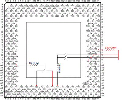

Reply 10 of 115, by Sphere478
how's this?
ugh, I wish I could upload bitmaps
As for the pcb, this also could be implemented (tillimook mods)
I’m not sure if any of these links may interfere with different model processors though… obviously they don’t seem to be of any harm in different mobos when a tillamook is used.
There are some reports of people needing to disable some of these mods on tillamooks to make them work right from one mobo to the next. So making them switched may be a good idea.
The attachment 99FF85AF-848D-4123-A2C0-AAF657C02EE5.png is no longer available
I also got to thinking that castellated holes could be used to recess a dip switch block as low down as possible for more clearance so as to allow motherboard to be more easily mounted
another idea, remote switches so that they can be more easily changed in a case

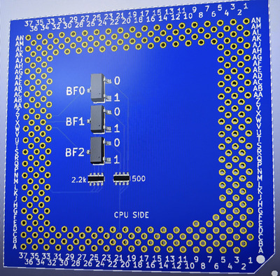

Reply 11 of 115, by wiretap
Here's a KiCAD v5 PCB-only file you can mess with. I also generated the gerbers in there too. The board outline will probably have to be brought in closer to the pins to clear the ZIF lever.
If you were to build this, I'd recommend milli-max individual pins soldered through the board so it can go into the ZIF socket on the motherboard easily, then the CPU would be on the top side PGA style.
The attachment socket7-mod.zip is no longer available

Reply 13 of 115, by Sphere478
wiretap wrote on 2022-03-20, 19:15:
socket7-mod.zip
I was figuring this would be soldered to the BACK of the board 😀
Like the pci slot thing I linked
Which brings up another thing,
We should put a castellated edge with a 3.3v tap for those 3.3v slot things
But lower profile outline is a good idea.
Many, all of the holes will have to wider so that they can go around the solder domes and then solder can be poured into the ones we wish to connect to, many of the others can simply be left not plated as to make trace routing easier.

There are also mods that make tillamooks work on desktop boards, issues there are voltage detect, l2 cache, and multiplier pin issues
We can also tap the cpu for 3.3v for the pci slots, especially if the cpu is dual plane. The 3.3v is over powered for a dual plane cpu so there is amperage to spare and can be used for the pci slot
And finally there are the multipliers.
There are four pins that I am aware of related to this, (three normal ones, and one for tillamook)
On many motherboards eapecially socket 5 bf0/bf1 aren’t properly pulled high, it’s a easy fix, and on socket 7 bf2 isn’t pulled high. Again a easy fix.
My goal is here to combine all these into one easy to install device that simply solder a few points on the back of the motherboard and presto, you now have not only the mods but also ways to shut them off and change their settings via switches.

Some notes:
The voltage detect mod should probably have a resistor pad and a switch
Cache mod #1 should have a pad and a switch
Cache mod #2 should have a pad and a switch
I believe the tillamook bf mod might be able to just be a link, but to be safe we should give a pad and a switch.
The bf2 tillamook resistor mod will be addressed at the same time as the bf0,1,2 mods
The last schematic should be good for the bf mods
We will have to do some digging into how to implement the wt/wb mod in a way that will work with all mobos.
My consern is the mobo probably already has pull high and pull low resistors for it and we will have to over power them.. (while the system may be pulling the opposite way)so perhaps pads for both, and values can be determined later? It seems that a double throw switch is required here to over ride the existing pull up/pull down signals? Am I right?
Also another concern is the affect of tillamook mods on other processors

Reply 15 of 115, by H3nrik V!
Sphere478 wrote on 2022-03-20, 10:41:
how's this?
You need 3 separate 25 Ohms as well 😀
[Edit; had posted my reply inside quotation]
[Edit 2 - Never mind, you don't need, I guess] 🤣
[Edit 3] You might not need 3 separate pull-downs per se, but you'll might experience unexpected behavior from having one shared, as current through it will change depending on how many switches are closed, i.e. better safe than sorry.
Reply 16 of 115, by Sphere478
H3nrik V! wrote on 2022-03-21, 06:20:
You need 3 separate 25 Ohms as well :) […]
how's this?
Yeah, I was figuring that one would do, I think the kingston is wired like that. But may as well add 2 more what can it hurt…

Reply 17 of 115, by Sphere478
Edit: an image of the prototype from wiretap
The attachment 5D830531-1476-4AE9-AF08-36C2306D46CB.jpeg is no longer available
new schematic
The attachment New Bitmap Image.png is no longer available
. check me for errors. I couldn't decide if the wt/wb should be a tripple throw so it had a neutral position or if it should be two switches seems like two switches is best because it is easy. since it has resistors that should make it safe incase both are turned on. so I think this should work.
I haven't put in resistor values yet.
I made the bf more complicated but I like that this way everything on the board can be totally disabled just by flipping a switch and go totally passive
everything has resistor pads, whether they need it or not. I'd hate to find out later they were needed and not have them (if you don't feel like installing them bridge it with solder)
this all means 12 switches. gonna get a little crowded, but I think it's doable.
does anyone else have a suggestion for mods needed?
I assume there isn't a problem combining all the vcc3 into one rail and tapping it for pci 3.3v power (when using a dual plane cpu)
For use with these:
Reply 18 of 115, by Kahenraz
I did the resistor mod on my ASUS P5A recently, but a dip switch on the CPU would be a lot nicer. I would rather not have this bodge on my board if it can be moved to the CPU. That way it can be easily enabled or disabled for testing.
Reply 19 of 115, by Sphere478
Kahenraz wrote on 2022-03-21, 13:46:
The idea is to have this on the back of the motherboard
Alternately, eventually, this may be able to be incorporated into catsay’s power leap interposer that adds cache.
It’s not impossible though that a version of this couldn’t be added to the cpu it’s self but the pcb would have to be very thin
There is just more room for switches on the back of the mobo, also breaking out the 3.3v for the pci is a secondary goal
“ Cat, what resistor values should be used on my schematic?”
Catsay wrote:
 330Ohm and 1Kohm should be fine
For other pullups/downs than BFx you can also use like 10K
The important thing is though that fast pins that get latched after reset (used as strap bit value initially and then for fast data transfers) use 'fast' resistors, this meaning low value resistors
