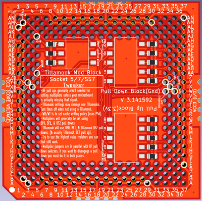

Socket 5/7/SS7 Voltage and Tweaking Interposer
What is it?
This is the culmination of all the different socket 5/7 mods in one package.
What does it do?
-Allows the use of processors in motherboards with incompatible voltages. Via vcc2 tap.

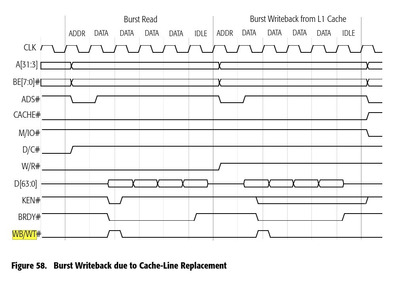

-Enables the usage of BF0, BF1, BF2 and Intel BF2 for setting all possible multipliers supported by any cpu.
-Has the p5a 1.05/1.06 fix (enable/disable via switch)
-Tillamook mods. For l2 cache/voltage detect
-Vcc3 tap for motherboards without 3.3v supplies.
-Allows you to set 2.5v vio for tillamook processors (not really needed, but you can if you want to)

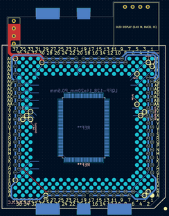

OP:
I know some of you including myself have been waiting for this for quite some time.
I have some learning to do, and it may take several prototypes but, I'm gonna try. And maybe with a little help, brainstorming, encouragement, and cooperation we can have a really great product in the end for all of us to DIY build and enjoy! :p
First off, I'm going to opensource this, I'll post incremental Files as the prototypes develop feel free to use them or modify them as you wish or see fit. (and at your own risk of course) but it is probably unwise to order/use any early versions that have not been prototyped in physical form and confirmed to be working without error.

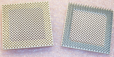

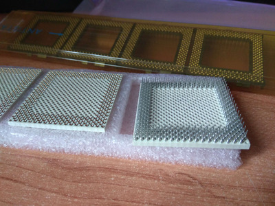

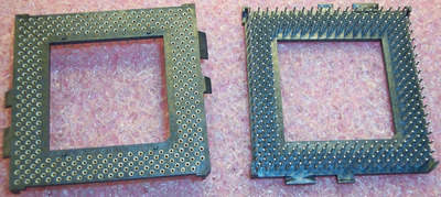

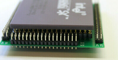

CPU Mounting And Pins:
One major hurdle that will have to be overcome is how to attach a socket that also has pins that will plug into a socket below
25.2 KiB
2390 views

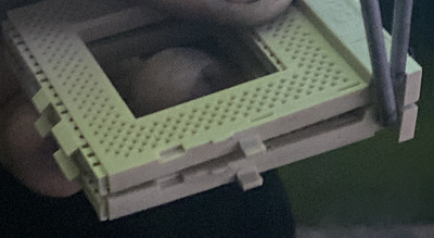

these can still be bought but are quite annoying to remove the processor once it has been inserted, also how do we expect to install proper heatsinks?
Which brings us to using ZIF sockets…
394.83 KiB
2389 views
But that has the issue of not working with the lever stops, and the issue of the pins being too short.

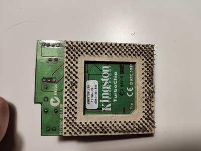

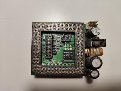

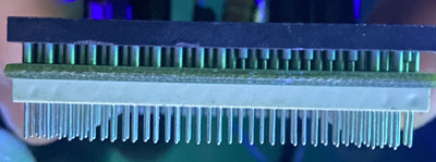

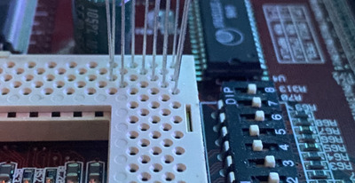

How has it been done in the past?
1013.4 KiB
2388 views
this device shown above seems to be using a custom LIF with very long pins?
can we find LIF with longer pins though? I can't seem to find any.

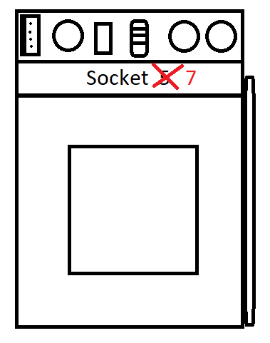

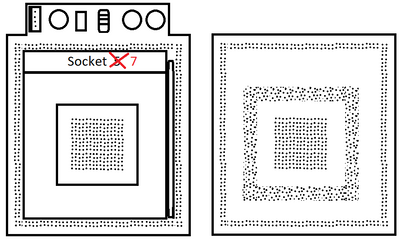

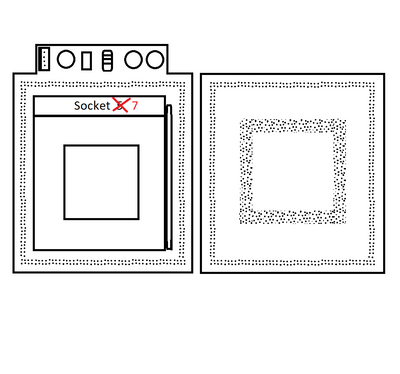

another idea ,offset the socket:
12.63 KiB
2383 views
or maybe a two part pcb:
17.62 KiB
2381 views
personally though, I don't like options that extend the length of the cpu lines more than a socket stack.
Do you guys have any ideas about how to turn a ZIF or LIF into a device that can solder into a board and still have pins long enough to still reach to the lower socket?

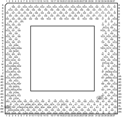

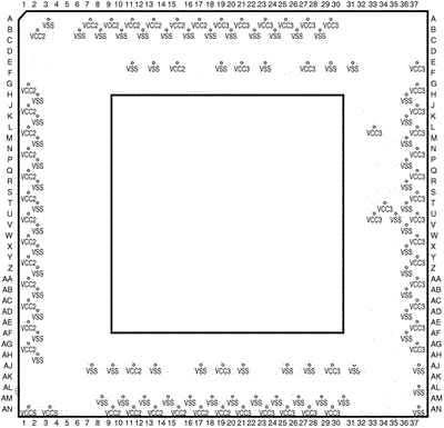

Pin Routing:
pin schematic:
61.36 KiB
2375 views
here are the voltage pins
14.42 KiB
2376 views

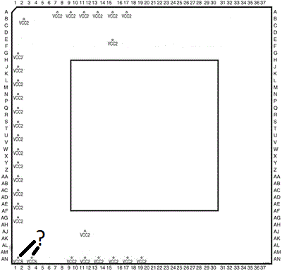

here are the ones that need to be severed and powered separately:
9.65 KiB
2377 views
there are other pins of interest but they have been researched and are pretty well understood here:

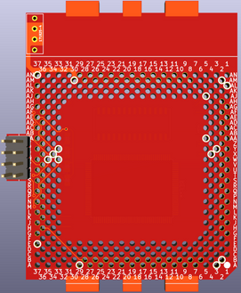

Socket 5/7/SS7 (Motherboard) Tweaker (Released)
384.66 KiB
2373 views

Reply 3 of 220, by Sphere478
here is a variation on an above idea: two parts: solder the sockets first then use jumper pins to solder the two board parts together, but add connections to the interior of the socket also. it may be possible to use resistor legs for the pins to install into the board socket.
17.1 KiB
2359 views
994.93 KiB
2329 views
I see two issues with this
-it lengthens the signals significantly, and may introduce interference
-it will make it not fit in quite a few motherboards with limited area around the socket
but it should be pretty straightforward to build... no super tricky soldering.
Apparently such a thing works on socket 3 in some capacity..
19.79 KiB
2341 views
Edit:

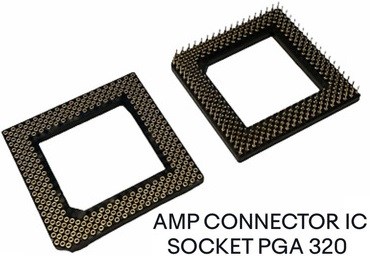

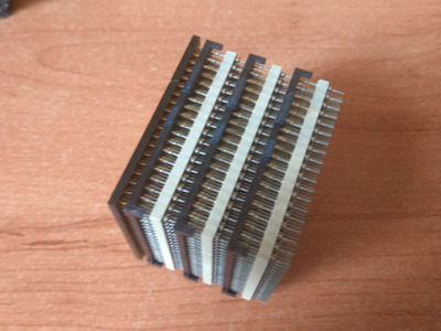

here is a interesting find:
"QTY (10) 321 POSITION PGA SOCKETS 19x19 COLD FORMED 390094-1 AMP NOS 1 TUBE"
289.62 KiB
2337 views
this could solve the heatsink and lever problem

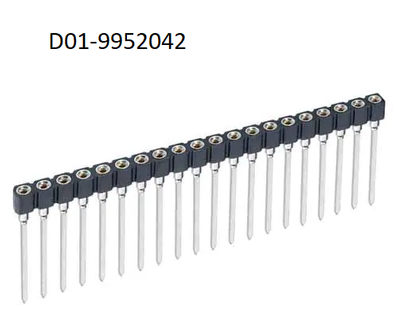

Reply 4 of 220, by Sphere478
okay, here we go, now we're talking...
67.11 KiB
2325 views
We could create the socket out of a bunch of these (and some of the shorter ones or simply trim some)
Sphere's PCB projects.
Reply 5 of 220, by 0xCats
You can't actually use these pin headers to create the sockets correctly
The pin spacing and diameter is not correct. They are also too thick and break the internal socket clasps.
But there is no need to use a janky pins of any sort at all.
Max-Mill PGA interstitial sockets already exist. (they are the same that the original powerleap etc designers used)
They can be stacked into another socket through a PCB.
The voltage pins can be removed from the interstitial to isolate it to just powering the CPU so as not to backfeed the mainboard VRM.
I already have a bunch for the "SoCat-57" adapter I'm making.

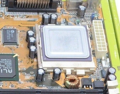

here is another thing I'm wondering about.
76.01 KiB
2310 views
how the heck to we keep this thing from hitting everything on the mobo 🤣

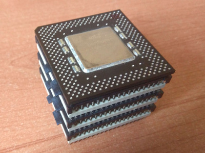

Reply 7 of 220, by 0xCats
To add something more
A dual PCB design with headers between them is almost entirely unworkable. Here is why:
I ran a simulation of it and tried with just normal stacked sockets to find out how badly it affects system stability and reliability. How many sockets can I stack with the CPU still working.
It's safe to say from testing that even 2x1 sockets stacked is a problem if they are not completely tightly wedged into each other. The Kingston turbochip module actually soldered the two stacked sockets to resolve this.
Even just 2x2 stacked leads to glitches and a lot of EMI, crosstalk and other capacitive coupling problems.
But at 3x2 stacked sockets as seen above in my pictures it is a total mess at the 66Mhz FSB.
And this was with tightly stacked sockets, with 2.54mm pin headers plus PCB trace routing I expect it to be much worse.
It works on a 486 and such due to their low FSB and much lower signalling requirements.
But for Pentium, especially for the Host data bus and cache controls it needs to done right or just becomes real glitchy mess.
As for the socket spacing, this is something that's relatively easy to solve with modern IC's, all of the voltage regulation stage can fit inside the socket and over the unused socket lever/cover area.
With modern electronics this can be even smaller than the original Kingston TurboChip module:

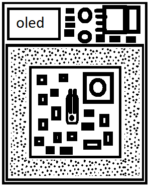

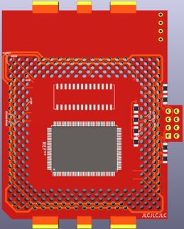

Reply 10 of 220, by Sphere478
0xCats wrote on 2022-04-02, 11:53:
I think the easiest way to flexibly control all of them would be with a modern microcontroller on the PCB that can detect the CPU type, voltage, multi, detect the pin state and load and set specific pin configurations all without needing to fiddle any dip switches.
At least that is what I'm designing around 😉
oh wow, that's next level....
would we need a comprehensive database of cpus and settings to make that work? (programmed into the controller) like, people would have to report data from their cpus and it would be added to the firmware?
9.9 KiB
2260 views
so obviously this is a crude render but you think that shrinking the size to something near this level is possible? (seems too small, also no cache chip... but there is room inside the socket on the bottom also 🤣.

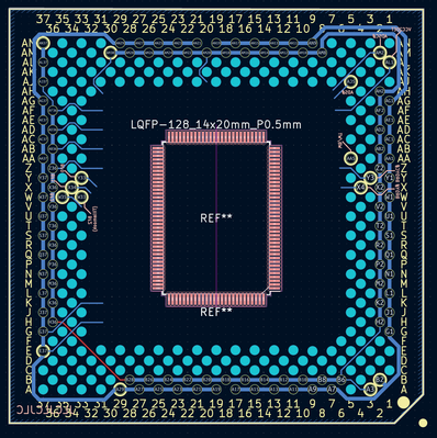

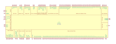

Reply 13 of 220, by 0xCats

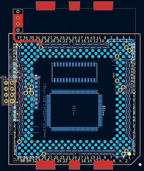

Created the Footprint + Symbol with all rule defintions 😁
Time to rock and roll
273.56 KiB
2210 views
There are two types of devices, those that know they've been hacked and those that don't yet know they're going to be hacked.

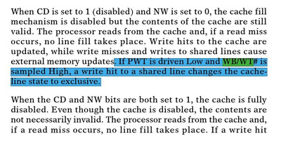

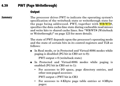

Reply 14 of 220, by 0xCats
Sphere478 wrote on 2022-04-02, 11:45:

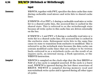

- wt/wb pull up and pull down switches
I just saw you wrote this, but controlling this line is not safe to do with pull resistors. It operates in unison with the PWT and KEN# signals.
See the documentation:
33.17 KiB
2198 views
This is a chipset controlled signal.
And from the AMD K6-2 documentation:
168.53 KiB
2198 views
175.04 KiB
2198 views
So tying this pin Low or High externally from the chipset will lead to some very unpredictable results.
Really the WB/WT# signal is used for complex behaviour and it's necessary to be rapidly switched in operation for setting Cacheline states among other things.
97.18 KiB
2194 views
And again here the signaling logic for a Writeback Cacheline replacement. If the WB/WT is static locked either high or low your processor will have a serious problem
(Note the BRDY and WB/WT signals) and how they correlate to D[63:0].
74.72 KiB
2187 views

Reply 16 of 220, by Sphere478
0xCats wrote on 2022-04-02, 17:48:
I just saw you wrote this, but controlling this line is not safe to do with pull resistors. It operates in unison with the PWT a […]
See the documentation:Screenshot_20220402_194350.jpeg

Reply 17 of 220, by Sphere478
Strange Socket 7 "mod"
Speaking of mods, may have missed one, this post^, if I counted my pins right seems to be doing two mods (one a known tillamook mod) and also a unknown one..
What do you make of this Oxcats
Cats, do you think that the cache chip you have spoken of could fit between the pins under the pcb?
How is the motherboard cache overriden? Severing of select pin signals to the mothetboard? Can the on interposer cache still be disabled via bios? Or will that need to be done on interposer?
216.43 KiB
2133 views
hmmmm....
Reply 18 of 220, by Sphere478
let's see,
Alpha 1
Alpha 1 Socket 5 7 SS7 Voltage and Tweaking Interposer.zip
1.3 MiB
26 downloads
here is the result of my tinkering (and dreaming) Oxcats: feel free to use any or all of this. maybe the edge cut may be useful. (I based the tabs on included socket diagram)
Edit: Alpha 2
Alpha 2 Socket 5 7 SS7 Voltage and Tweaking Interposer.zip
1.14 MiB
27 downloads
188.23 KiB
2105 views
317.96 KiB
2105 views
171.91 KiB
2105 views
http://db.zmitac.aei.polsl.pl/Electronics_Fir … ex/29746702.PDF
so I'm guessing the cache attaches to the host bus but doesn't matter where. and the pins on the cpu for the bus are as good of place as any. and to disable motherboard cache we just divorce a few select pins and presto, the cache on the interposer is now the active cache? am I following this right?
Reply 19 of 220, by Sphere478
I found another way it was done:
102.51 KiB
2079 views
Edit:
Alpha 3
Alpha 3 Socket 5 7 SS7 Voltage and Tweaking Interposer.zip
1.47 MiB
28 downloads
    231.97 KiB
    2069 views
    386.53 KiB
    2069 views
    396.65 KiB
    2069 views
