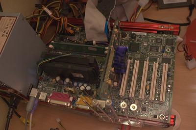

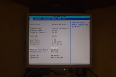

Reply 3 of 32, by flupke11
I've just set up the 820 on the bench board. The mainboard is brand new, it still has that typical PCB-smell when you get it out of the antistatic sleeve. I wonder if they put that smell in cans, just like they do with new car smell or wet dog smell.
Boot version is VC82010A.86A.0031.P11, out-of-the-box. Be warned that the large capacitors are very close to the slot-1, some of my Slot-1 CPU's have custom coolers, and the backplate of these coolers protrude by about a centimeter which renders these unusable on this board. The OT's goal is using a pinmodded Tualatin, which means a Slot1-FCPGA convertor. That shouldn't be an issue.
Testing:
1 64 MB stick PC800 + continuity rimm: OK
1 256 MB PC1066: OK
2 256 MB PC1066: OK
It boots happily with a Katmai 500, no surprises there. Speedsys (569,3)
No issues with a 700/256/100 Slot 1 Coppermine. Speedtest (795,55) - 743,70 MB/s - The P3B-F got 804,99 in Speedsys with this CPU, The 100 FSB is a bit more agressively timed than Intel's stock choice (99.73).
Soltek SL-02A++ Slocket with a Celeron 800/128/100: No issues, works as advertised. Speedsys (909,82) - 743,69 MB/s
Soltek SL-02A++ Slocket with a PIII 866/256/133 SL4CB: no issues. Speedsys (985,03) - 984,60 MB/s
Soltek SL-02A++ Slocket with a PIII 1000/256/133 SL5FQ (Tualatin-a-like, 1,75V): doesn't boot
Soltek SL-02A++ Slocket with a PIII-S 1400/512/133 SL6BY (Tualatin, 1,45V): doesn't boot
Powerleap iP3/T with a PIII-S 1400/512/133 SL5XL (Tualatin, 1,45V): doesn't boot
Powerleap iP3/T with a PIII-S 1,26/256/133 SL5XL (Tualatin, 1,45V): doesn't boot
tl;dr Anything newer than stock Intel Coppermines won't work on my board Tualatins don't work (at the current state of affairs)
