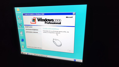

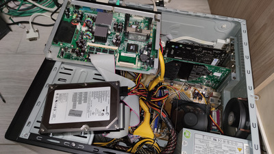

Reply 42 of 52, by biessea
So at the end installing Windows 2000 with a master hard disk and the slave CD-ROM it works.
We can so assume that the problem is the CF card on that system, even if in my primary computer it can be formatted, it can transfer files and read them?
What suggest do you have about putting a CF as master drive in this thin client? I am simply worried that If I buy one for 10 euros it simply doesn't work as this one do.
I put photos about the hard disk and cd-rom with the same IDE cable connected
    161.47 KiB
    694 views
    Windows 2000 correctly installed
    723.79 KiB
    694 views
    thin client with IDE cable and HDD+CD-ROM master/slave mode
